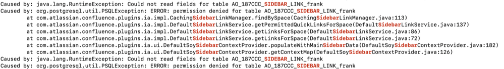

Fayezul Bhuiyan
May 20, 2025
I also had the same issue. Log said DB permission issue:
I worked with DB team and fix the permission issue.
