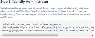

admin
August 22, 2017
I am following that guide, useful, but I am still trying to achieve the first step (DBV installed and connected to the DB)
That code goes...?
Nic Brough -Adaptavist-
August 22, 2017
I don't understand the question.  You say you are stuck on the first step and then paste in a query that is the next step.  In neither case do you explain the problem you are having.
Where are you actually stuck?
admin
August 22, 2017
This code: where shoud I paste it in DBVisualiser. It is connected to de DB, I have been looking for that some kind of box to type but I just find menus and buttons...
August 22, 2017
Ah, ok.  I don't know, I don't use DBVisualiser.  I go with command line mostly.  There should be an option for "run plain sql" somewhere in it.
