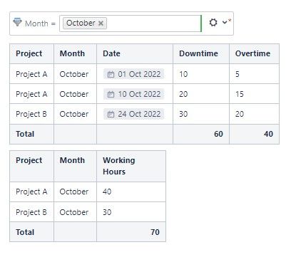

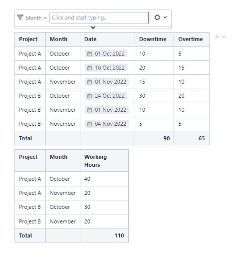

I have two tables:
I am using a table filter macro to calculate SUM of hours in each of the columns: Downtime, Overtime and Working Hours.
I am trying to figure out if there's a way to join these two tables, so I can
a) see the total of Downtime, Overtime and Working Hours per Month in a single table;
b) use a formula & build a chart that would show what is the percentage of Downtime (60 hrs) out of the Total working hours (70 hrs) for the Month of October.

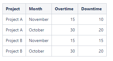

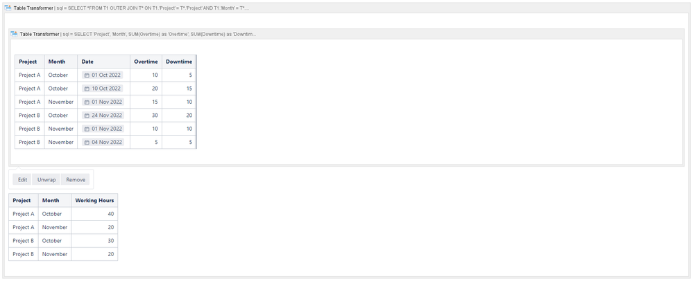

Then you nest that macro into another macro on the page that also has the second table in it. The query for the outer macro would look something like this:
SELECT *
FROM T1
OUTER JOIN T*
ON T1.'Project' = T*.'Project' AND T1.'Month' = T*.'Month'
In the edit view it looks like this:

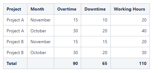

and the end result looks like this:

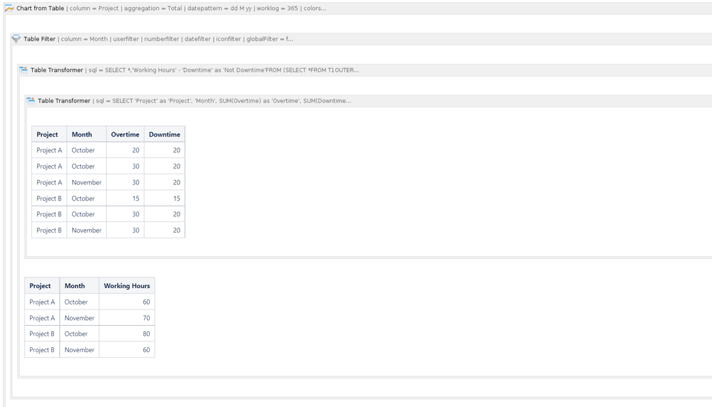

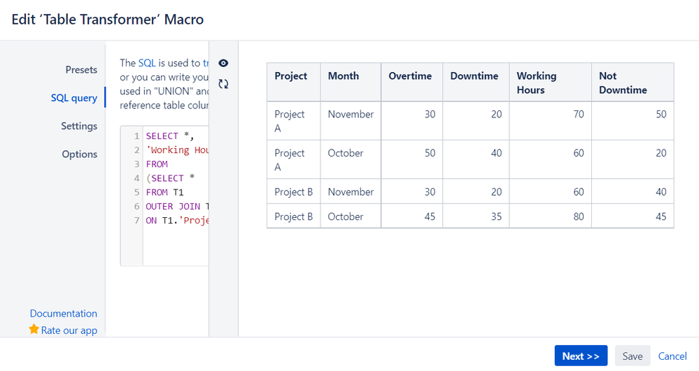

To wrap everything, I can suggest the following structure:
The query for the internal Table Transformer macro is left as it is.
The query for the external Table Transformer macro is as following:
SELECT *,
'Working Hours' - 'Downtime' as 'Not Downtime'
FROM
(SELECT *
FROM T1
OUTER JOIN T*
ON T1.'Project' = T*.'Project' AND T1.'Month' = T*.'Month')
We’ll be using the new “Not Downtime” column later for our chart.
Here is the outcome of our macro:

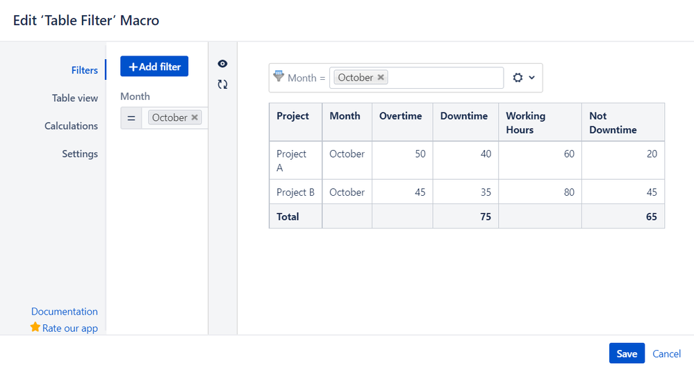

The next step is to filter your table by month and count the required totals:

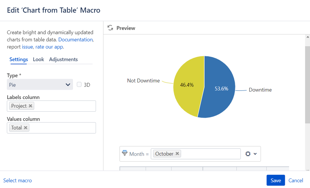

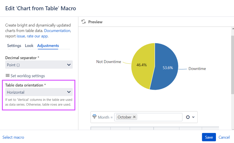

The last step is to build your chart:
