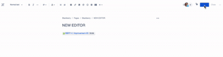

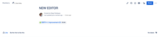

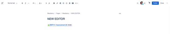

Edit Mode:Screen Shot 2020-09-07 at 12.06.06.png
View Mode:Screen Shot 2020-09-07 at 12.05.52.png
The closest I go to the described issue was when the macro temporarily displayed the issue as a link instead of the macro while loading:

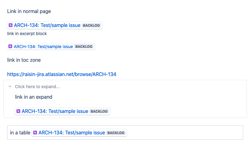

3. attached
4. i created a new issue to test against and reproduce the behavior
I think I figured it out: the links do not render when published if inside a "table of contents zone" block on the page. They do render while editing.
I tried several cases (normal, inside excerpt, inside expand, inside table) and this was the only one that failed to render.
That's unfortunate (the TOCZ is a neat feature in the case of the page where I was originally working). If you don't know of a workaround, I suppose we should file a bug report?
