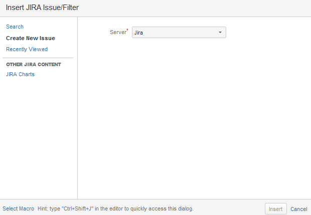

But on the tab 'Create a new issue' I can see only 'Jira' field
but not 'Project' , 'Issue Type' ...

Hi @Alex Kiselev _Itransition_ can you please provide a screenshot.
October 4, 2023
Hi @Craig Nodwell
Please find the screen below.
On investigation I have found that Confluence is loading the Jira projects to be placed on the form with
<Confluence URL>/rest/jira-integration/1.0/servers/<ServerID>/projects?_=XXX
And this REST call fails with
JiraErrors{errorMessages=[Issue Does Not Exist], errors={}}
