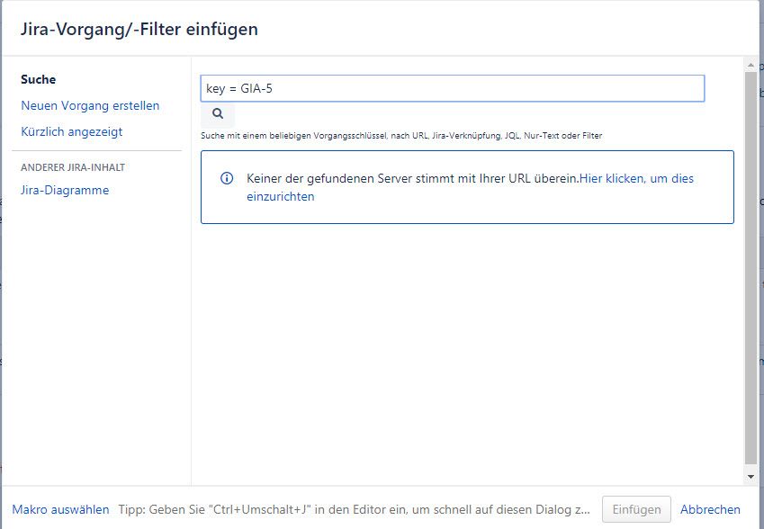

i have serverall issues with the jira macro in confluence:
  1. it keeps loading forever.

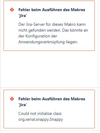

  2. it doesnt work at all
  3. it doesnt find the issue if the page was created with GAIA.
    07-04-2018 23-33-35.jpgIf i press enter the issue is found.

I can create issues with the macro and click on the link to get to them, but i still get an indefinitely loading icon
which the results in following error
