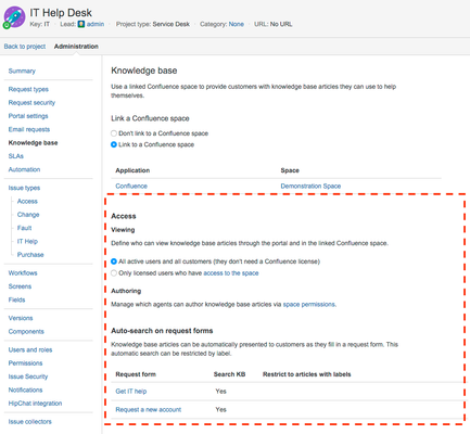

I have a problem with the Jira Service Desk --> Confluence link. I have managed to connect both products (through OAuth, showing correct status) and I have linked a Confluence space to a project but when I am in project settings -> knowledge base I can see a list of spaces linked to the project but below the list I can see an error instead of a permission section.
I should be able to see something like that:
