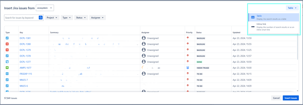

An update from our team: we've checked the behavior of the new Jira macro and it works fine for us.
Please check if you've switched to the table display of the result table:
Then you should see your table just fine.
The Jira Legacy macro is an old macro and it has been working fine too (you should also choose "Table" in the Display options of the macro).
