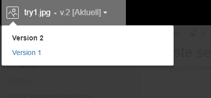

upload a new jpg with the name test1.jpg, edited the picture on my computer, afterwords save it and upload it again with the same name test1.jpg.
at confluence I couldn't download at the attachments site the different versions.
I've found out, if I view the file with click on it (Pictureviewer in confluence): Version vergleich pictureviewer confluence.PNG
I could have a look at version 1 (the right one!).
But if I go to the attachments site, I can't see the right version of "version1", there I only get version 2 (although there are 2 different files)

The different here I've marked in bold (way over pictureviewer, there isn't any "amp;" in the link, but at the attachments site, there is?!)
Next very curious behavior is:
If I open like the way over attachments site and edit the link manual (remove the "amp;" that I've get the link like way over picture viewer) and load it, I've got the right version!
BUT: If i edit manual the link, remove the "amp;", load the site, and want to have a look way over the picture viewer like this:
Version vergleich pictureviewer confluence.PNGI cant get the right one of "Version 1". After this manual edit of the link, you can't get Version 1 without accessing the file system and search for it...
