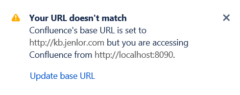

2. Unable to change base URL. Each time I go to localhost, it tells me that the base URL is different and when I go to change it, a pop up continues to state that the base URL isnt the same.

  • Let me know what you see in the browser when Confluence won't serve over port 80: I have used IE, Chrome and FireFox.
  • Post a screen shot of the base URL message because sometimes it will reveal where Confluence "sees" the request as originating, which could be a clue.
  • So that I can better understand your configuration, please post the contents of your server.xml file from <Confluence_Install>/conf directory.

The issue you are reporting with the editor after upgrading is sometimes related to a base URL mismatch, so let's sort out the port and base URL and then move on to the editor if it is still misbehaving.  Unable to edit any pages in Confluence 6.x due to Collaborative Editing
A mismatch of Base URL and Access URL will result in users unable to edit any pages.
To help me investigate, please:
  • Let me know what you see in the browser when Confluence won't serve over port 80.
