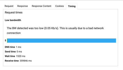

I had a look at your HAR file, and indeed, I can see that it took 6.023 seconds to load. You can compare that using the Google Apps HAR Analyzer.
I do see on the long request, there's this message under Timing:
When I asked about your firewall or proxy, you said that "different users try different options." Can you let me know what you mean by that? Have your users tested outside of your company firewall without being connected to a VPN or any other proxy network? If your server admin has a local proxy set up on the Confluence server, then you will also need to bypass that. See How to Bypass a Proxy to Test Network Connectivity for more details.
It seems that it may be an internal issue. However, I would be happy to raise at ticket for you with Support if you continue to have issues. Then we can work with you to confirm where the issue lies and how you can solve it. Please let me know and I can do that for you.
