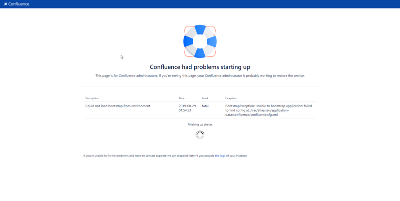

Shortly after running the startup cmd the cpu usage and ram growth will level off and navigating to the confluence instance will show this " Could not load bootstrap from environment " error.
When I google that error I find some docs saying it might be a corrupt config file but seeing as it remains untouched in a persistent volume during upgrading and still works if I revert back to 6.15.7. I expect that is not actually the issue here.

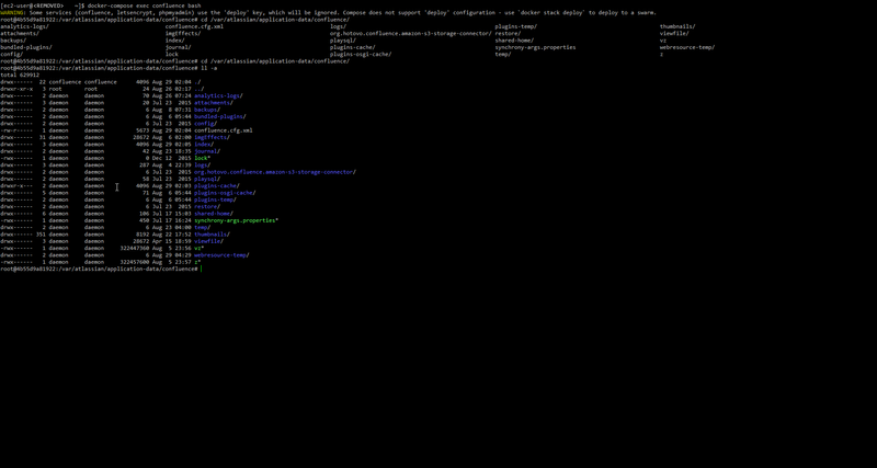

If I navigate around the confluence docker containers filesystem I can see that application-data is still mounted and what looks to be the permissions I would expect.

Pretty sure I figured it out, ended up being a premissing error.
A change made earlier this month switched from running the confluence appdata dir under the built in deamon user, to creating a new confluence user with uid:gid of 2002:2002 during startup and running under that. Also I'm pretty sure the confluence docker image used to always run a chown on the /var/atlassian/application-data/confluence/ dir during startup to prevent issues like this but I guess that isn't working or has been removed.
Here is the specific change: https://bitbucket.org/atlassian-docker/docker-atlassian-confluence-server/commits/00d24164db7d667f03c9d1adefeffaf81984a6ad
I ended up just running chown on the host system to change the permission of the persistent volume before starting up confluence 6.15.8. On my host system my persistent volume is mounted under /home/ec2-user/confluence/ so I ran the following cmd for a fix:
sudo chown -R 2002:2002 /home/ec2-user/confluence/
 After which I can start docker like normal and confluence 6.15.8 now works with previously created persistent volumes.
