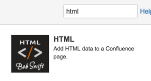

  5. Create a Confluence page (or edit one you want to embed the view on)
  6. Click the Macro menu and select "Other Macros"
  7. Search for "html" and select the HTML macro
  8. Paste the code you copied from Tableau into the macro body and save the page
