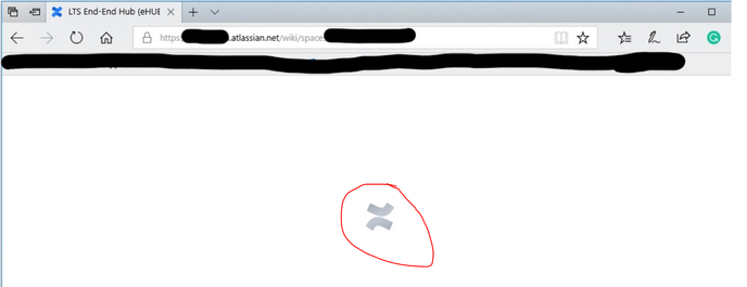

I am having the same issues as @Joe Carrow I have reset my Edge browser and restarted my computer. But still have the same issue. I am using Edge to access Confluence Cloud. Jira works fine on Edge for me and Confluence works for my coworker with no problem.
I log in to Jira Cloud and then try to get to Confluence but I end up with a blank page and Confluence icon in the middle of the page - as shown below.
Your help and support is much appreciated.
