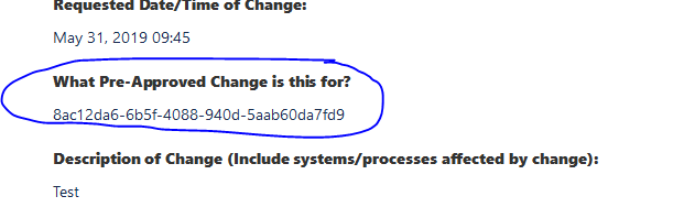

Hello! It's me again.
I am working with a Smart Dropdown and I am using an IFTTT to create a new page and also to send an email based on values entered in to a form. I have a form with a text box which dynamically creates values for a smart dropdown in another form. When the user selects an option from the smartdrop and submits the form, a new page is created and I am using the [entry.mySmartDropdownField] to try getting the new page to show the value selected. However, when the new page is created, instead of getting the text value I get a Hex value. (See Image) I was looking at virtual functions to try and convert this to text but did not see anything for it. Is there some other method I can use that is built in to confiforms to accomplish this?
As always, thanks for the assistance!
-Curtis
For those of you looking at this, I discovered there is a checkbox in the Form Field Definition macro for 'Reference to records'. If this box is UNchecked, the value comes through in text form.
-Curtis
When you uncheck the mentioned parameter then ConfiForms stores a plain value, not a reference to the field. Which may or may not be what you want.
The drawback of this is that you loose the reference to original record and cannot access ANY other properties from a referenced form/record
While, when you have this option set you can access ANY other property from the form referenced
[entry.mySmartDropdownField.property_in_other_form]
For this, I only need to get the text of the selected item. It is being emailed and used to create another page to display the information. No need to access any other property from the referenced record.
Well, do you understand that smart fields they operate on IDs of the records they reference? And think of them as "bridges" to another forms
So, in order to get the "text" value you need to tell where this text value actually is and that is by telling the smart field to get it
property_in_other_form is YOUR TEXT FIELD in the form referenced by this smart field
Hmm, I am trying to wrap my head around this.
So for the Smart Dropdown, I have the page where the form is defined, I have the name of the form, and I have the field name in that form which I am using to populate the Smart Dropdown.
I am using [entry.mySmartDropdownfield] with the 'Reference to records' unchecked. When the form(containing the Smart Dropdown) is filled out, a new page is created to display this information, and it prints to that page the actualy text value an not the ID.
When I have 'Reference to records' checked, then the ID is what comes through.
Would I need to use something like [entry.mySmartDropdownField.text] or something along those lines?
