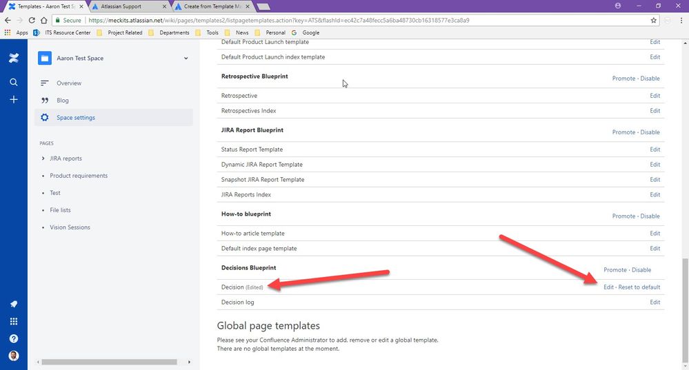

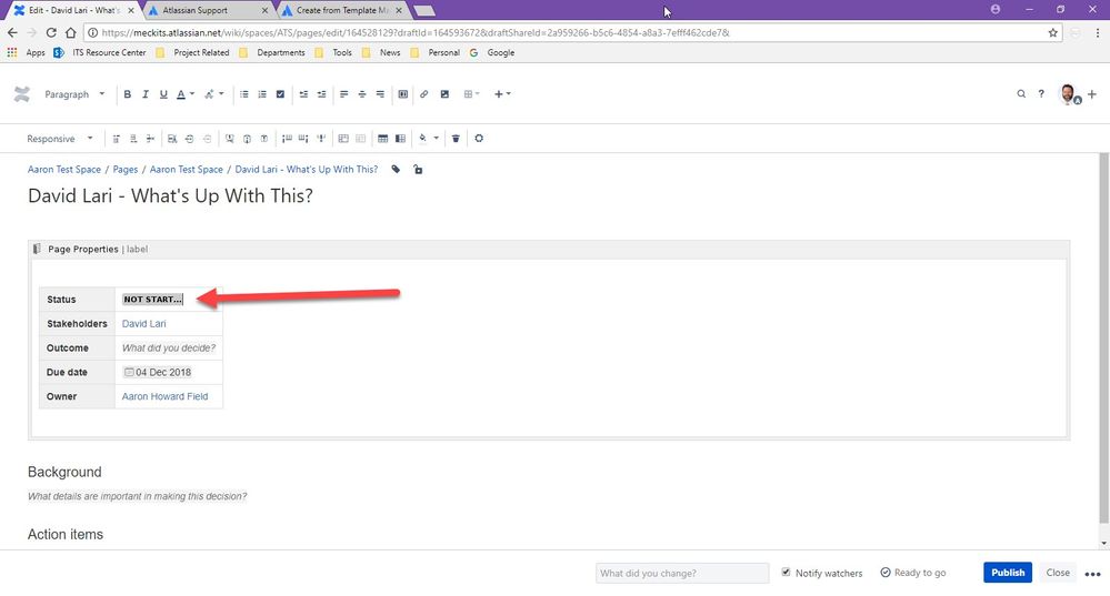

For the space I am currently working on, I am the owner and Space Administrator. My version of Confluence is Cloud based.

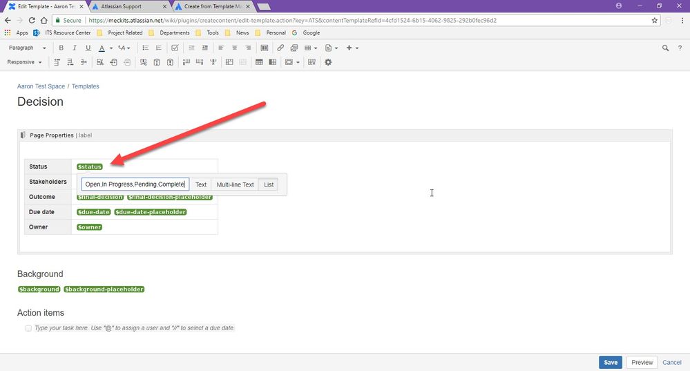

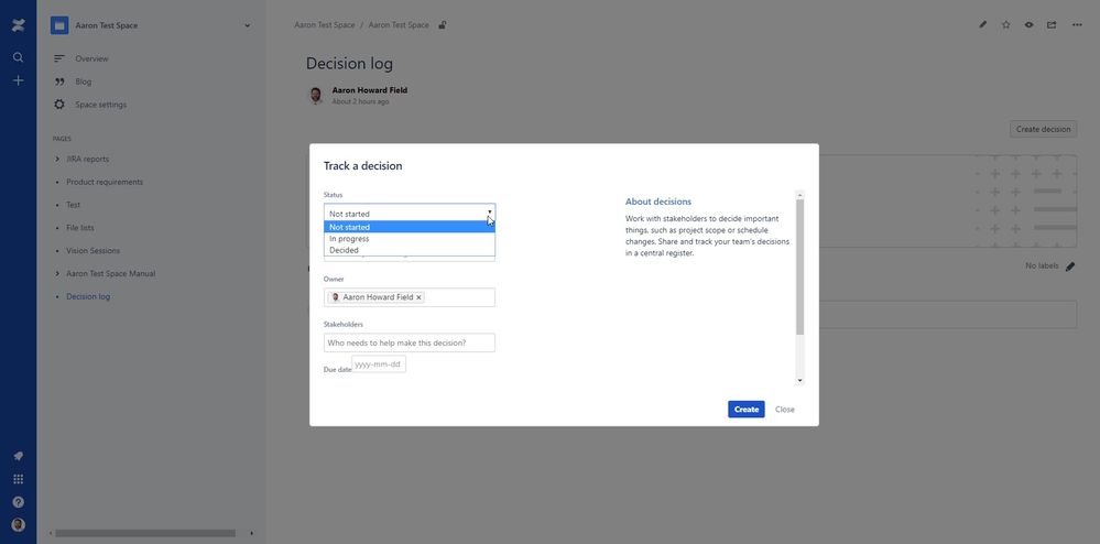

I selected the Edit link for the Decision template located under Decisions Blueprint (Space Settings - Content Tools - Templates) and modified the Status variable response option from a Text field to a List field. The options I provided for the List field were Open,In Progress,Pending,Complete. After I save my changes, I attempted to create a new decision page and found that my modifications were not appearing in the status field, but rather the original out-of-the-box Text field option Confluence provides.
Please let me know if I am doing something incorrectly or need additional permissions. Thanks

I would like to start by saying that yes, accessing the feature to edit Blueprints is indeed bound to your permissions in the instance. We need the administrator permission for such. The situation we are facing seems to stem from the fact that currently, we can not edit the values of system variables.
Even though the interface allows values to be inserted there, the actual value is controlled server side.
As a possible workaround, you could create a new template and set the variable values as desired:

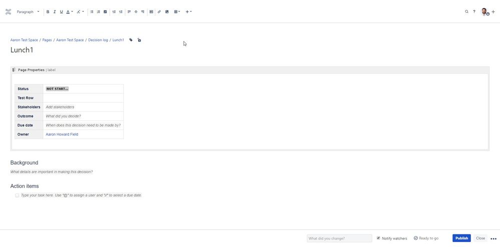

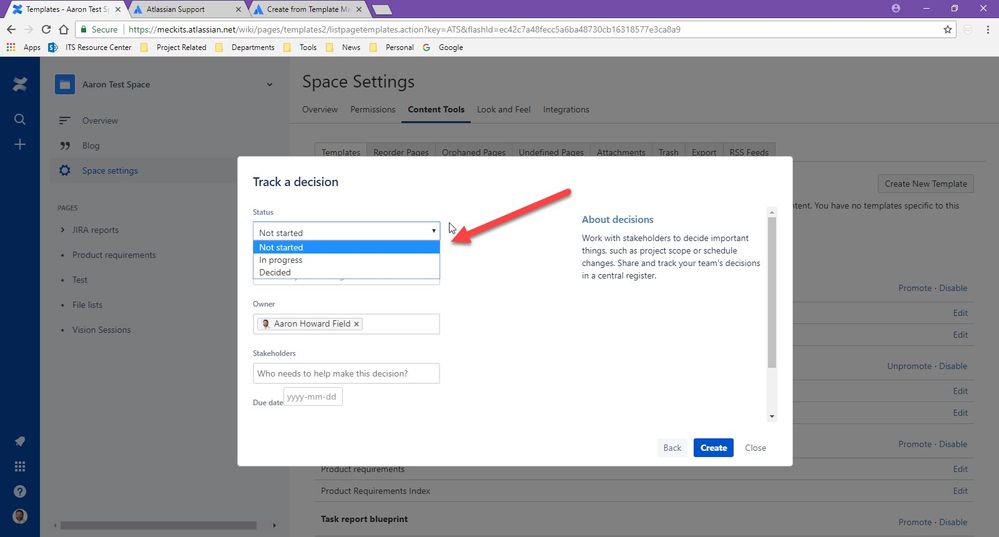

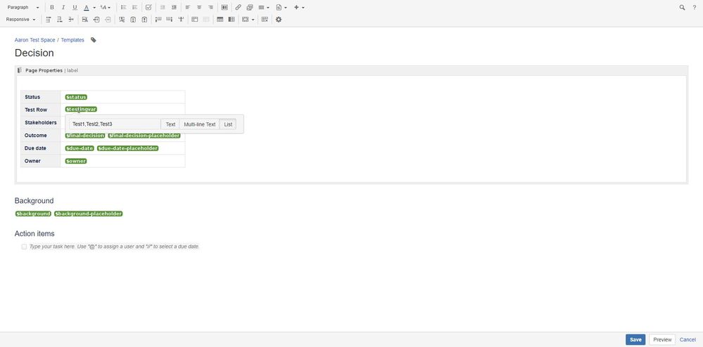

@Diego I am still having issues with the updated/edited template. My Confluence Admin set me with permissions for Site Administrator, so I am able to see and manipulate the settings globally.
As a test, I added a new row to the Decision blueprint/template table form and called it "Test Row" in the label section. In the next cell of the row, I created a new variable called "$testingvar" and set it's property to a list with the values of Test1,Test2,Test3. I saved the updates to the blueprint/template and went back out to my Testing Space. From there, I removed the existing decision log and decision pages from the space and added them back in, thinking this would purge and reset what is being pulled in from the Decision blueprint/template.
The result was being able to see the "Test Row" on the newly created and published Decision page, but I was unable to see the list drop down with the values of Test1,Test2,Test3. Also, when you initially create a new decision, it doesn't show the new row on the popup dialog box that appears for the initial data entry of the decision.
We are stuck from here and do not know what else we need to do to make the blueprint/template updates apply to the site.

For you to replicate the experience provided by the built-in Blueprint (dialog box, new fields), a new Blueprint needs to be created. Our Confluence Cloud Developer Documentation can introduce this part:
Some programming knowledge is needed to implement this.
Further, searching reported issue I could find this:
CONFCLOUD-37807 | "insert a variable into a template" on System Global Template Fails
I was able to reproduce the issue using both the toolbar insertion and also the $ shortcut. We could go ahead to Vote and Watch this report. Voting increases the issue visibility and watching will keep you up to date with changes applied there!
For short:
- Developing a new Blueprint is needed to implement the same experience bundled Blueprints offer
- There is a bug report listed to tackle the issue with new variables not being respected
