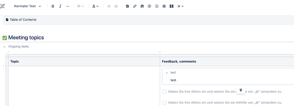

thank you for your reply, yes, I have an option to add action items once I add the expand macro but these added action items appear below the expand field, see screenshots please:

Thank you for sharing that. From your screenshots, it appears that you're trying to add tasks inside an Expand Macro which is inside a table.I was able to confirm this on my site.

It appears that this is a result of this issue:
The table is causing the macros to be nested, which isn't supported at this time.

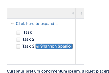

Thank you for confirming that. However, your screenshot is of the new editor and isn't an example contained in a table. To clarify, I was asking if you could test this combination using the Legacy Editor template instead.
Here's an example of it working on my site, within a table:CleanShot 2020-08-04 at 12.40.47.png
Since I was able to confirm that it's possible to nest tasks inside of an Expand Macro contained in a table in the Legacy Editor, you can use this as a workaround for pages where you need to do that.
