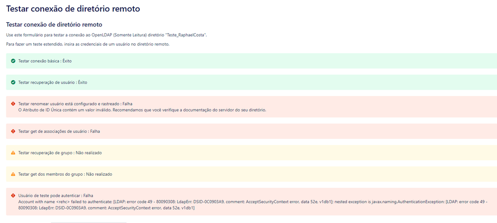

I can see there are three errors in red. Would you mind pasting the errors in english ? The last error says that it has failed to authenticate a user with name "rehc". Could be something wrong with that user setup. If possible try to delete it and run test again.
Hello, the error is this:
Test get of user associations: Failed
I've already tested it with several users, including Domain Admin user and the error persists
Ok thanks, it seems like the LDAP is not able to find the user membership. Can you check the confluence-home/logs/atlassian-confluence.log file and see the reason why sync is failing.

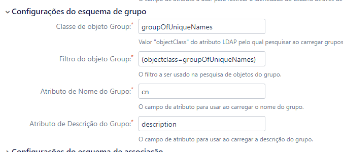

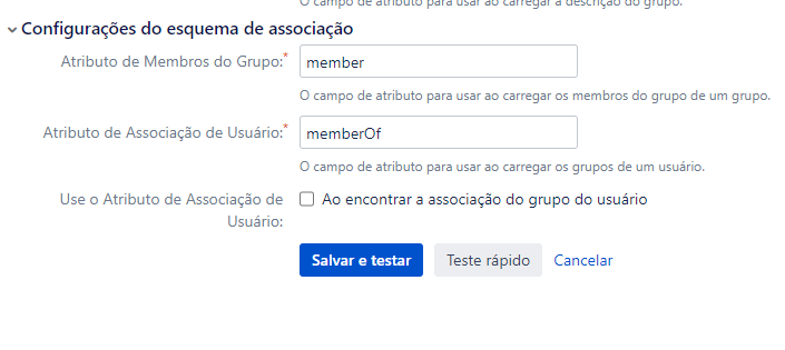

Thanks for confirming. If the Server settings (Hostname/port/username/pwd) are all correct, the next things to look at is the LDAP schema, where you will need to setup Base/User/Group DN correctly and the User/Group schema settings. You might need your LDAP SME's help on these. Once this is done you should be able to quick test the directory sync on JIRA.

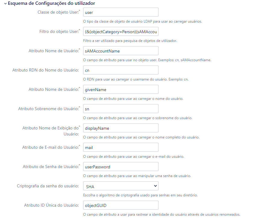

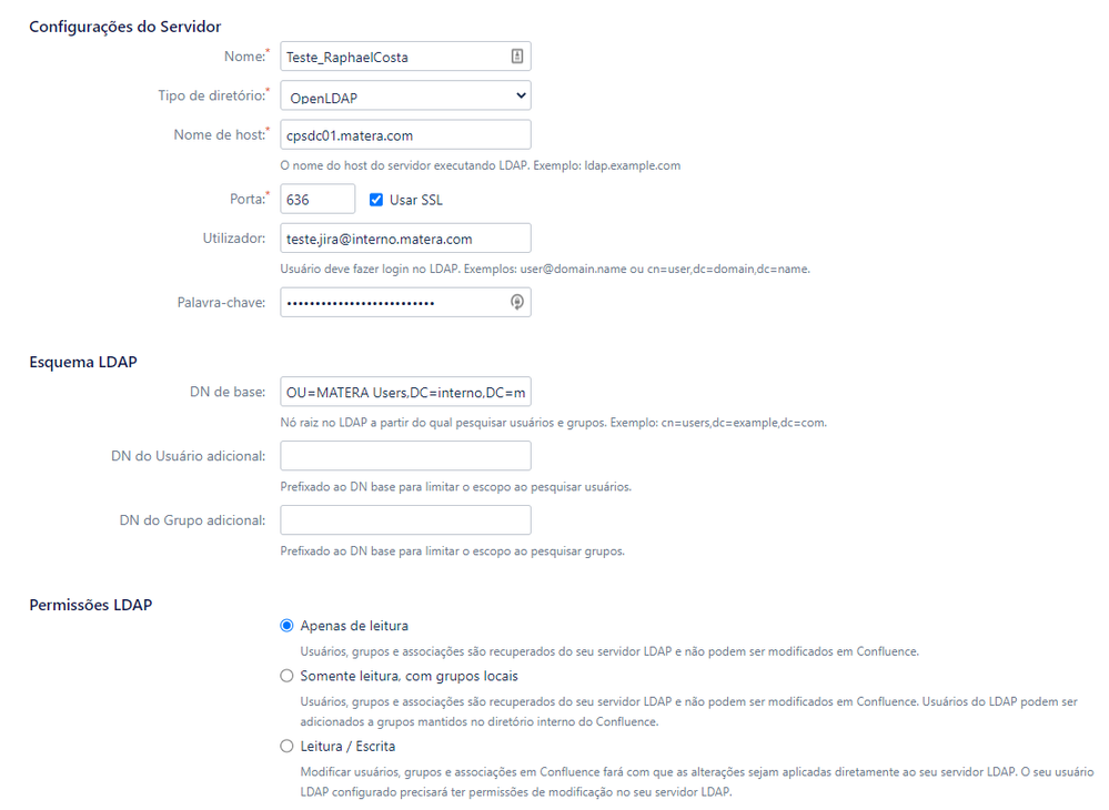

It's all very strange. The first time I did the setup, it went with some errors but it synced all users; now it no longer synchronizes and the error occurs as per the print;

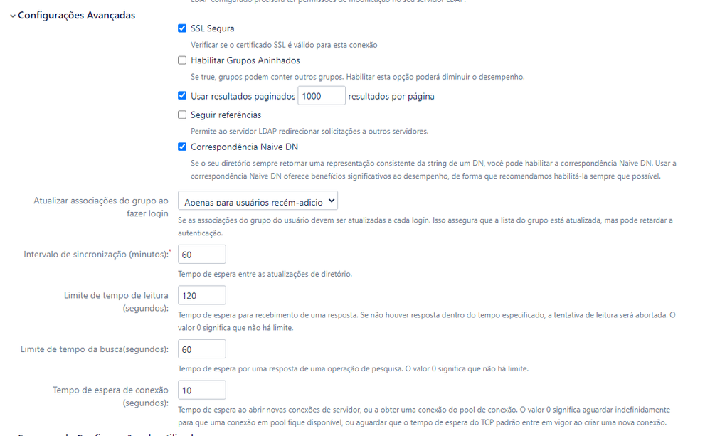

My configuration also attached for you to help me
