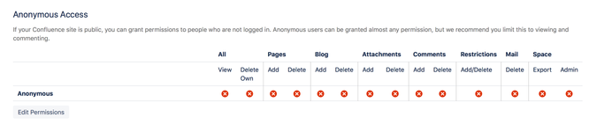

Apache isn't required to allow anonymous access. You'll have to enable anonymous access on the site level
and also at space level.
Enabling site level doesn't enable for each space. Setting Up Public Access
