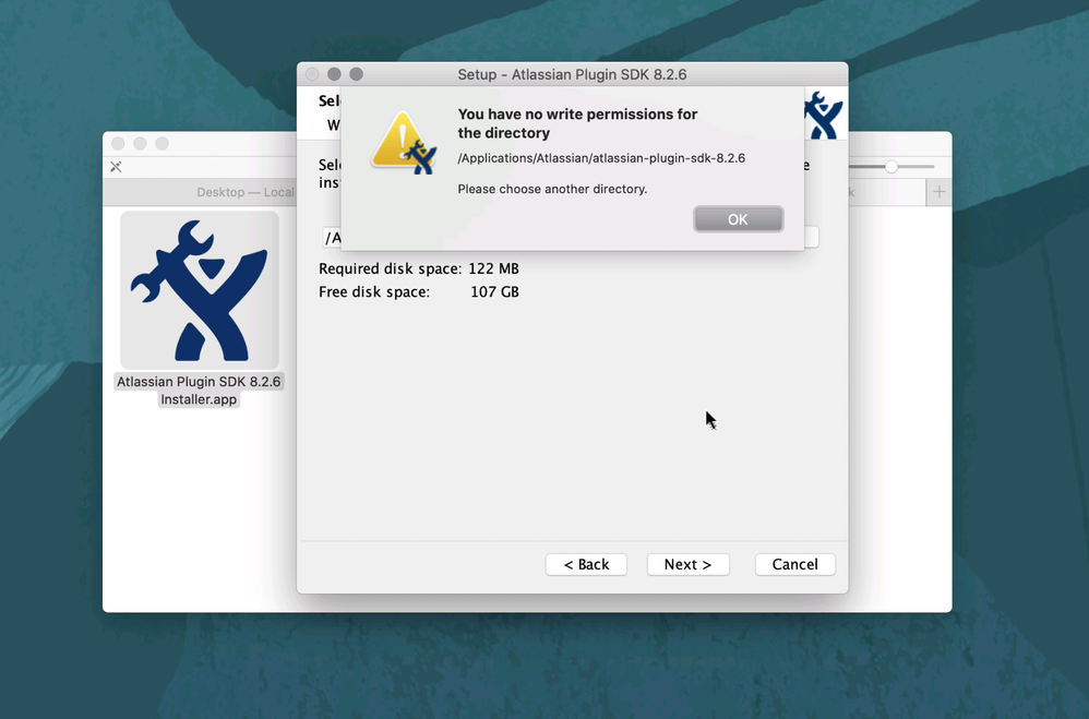

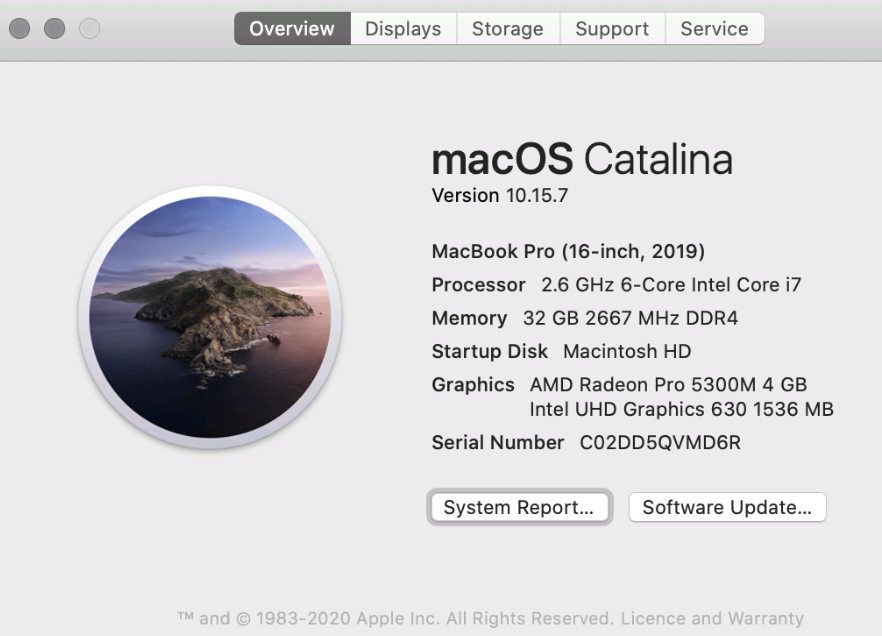

Calum
February 8, 2021
The 8.2.6 installer still doesn't work for me on 10.15.7 without the workaround I mentioned. The installer has no permission to write to /Applications unless you're an admin user, so it has to be run from command line with sudo instead.
