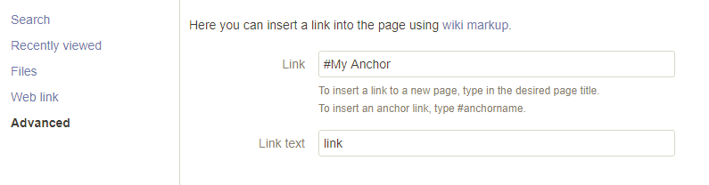

BTW: The anchor may contain spaces:
The Anchor Macro:
The Link (in Advanced Mode): Do not encode the Anchor name, preserve the space as is.
The rendered HTML
<a href="#MyPage-MyAnchor">link</a>
