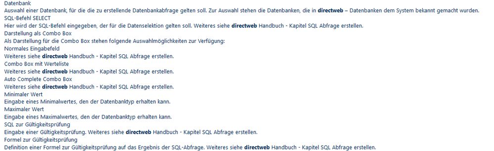

I have imported many documents from Word (.docx). It is the same for all:
The pargraph break at the end of paragraph that is used by Word seems to be different from Confluence's pargraph sign.
There is a line break in the Confluence page wherever there used to be paragraph break in the Word document. But it is not a "real" paragraph break.
For example:

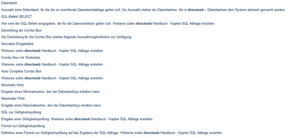

This is the result of the import:
In order to make it appear right I must do this:

After this treatment, the Confluence page will look like this:
Doing this manually is a real chore. Especially as I have hundres of pages to treat :-(
