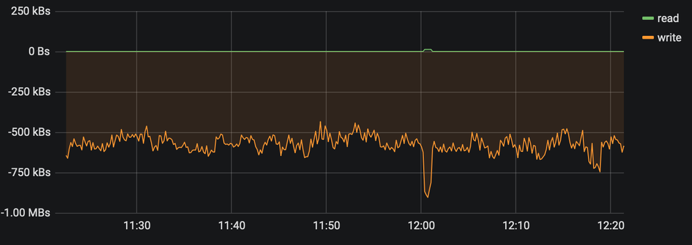

Hi all,
I run a small self hosted Confluence 7.5.1 instance. 10 user license, not much load.
My system monitoring sees a constant write load of about 600k/s to disk with just Confluence and MySQL running and definitely no active users.
What can I check to find the cause of this?
Operating system is Ubuntu 20.04 server, no graphical user interface, just this one application.

The instance is perfectly accessible and performing well. This is not a performance issue. It is just that this server is writing to the SSD 24x7 which will possibly wear it out sooner than desired.
An idle application should not continuously write apart from some bookkeeping every couple of minutes or so, shouldn't it?
