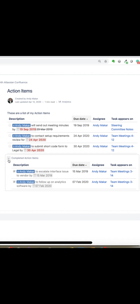

I’ve seen examples where by the task box is marked as ‘complete’ and Confluence moves the completed task to a separate table below accessible by a drop down link - does any one know how to set this process up?
Screen shot of what I would like to achieve:
Many thanks

Pretty sure that the way this is implemented is by using two Task Report macros with the same filter. Additionally, the first macro is set up to only show incomplete tasks, while the second macro is set up to only show complete tasks. This should "move your tasks down" to the second macro once you complete them. Hope this makes sense! :)

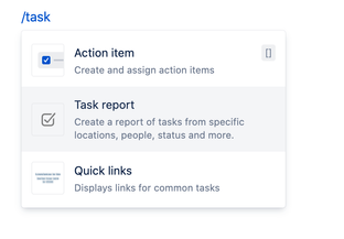

Not sure whether you're on Server or Cloud but you need to insert the Task Report macro into your page. Like this:

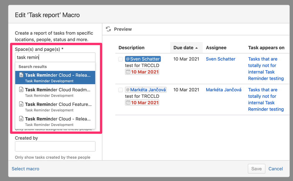

Sorry, just saw that you had a second question! The Task Report macro also allows you to filter for tasks that are on a given page. So you can decide exactly what tasks will be displayed. I think this is exactly what you want:
There's even more filtering options in the macro. Definitely have a look at it, I think it can do exactly what you need. :)
