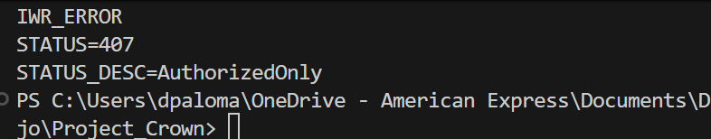

I’m calling this API:
GET https://aexp.atlassian.net/wiki/rest/api/content/2091981194?expand=body.storage,version,space
I tested with my own Confluence email and API token (Basic auth with Base64 email:token), both in script and direct PowerShell/API call.
Current behavior from my environment:
  • Direct reachability test to Confluence endpoint returns:
    • STATUS=407
    • STATUS_DESC=AuthorizedOnly
  • This indicates corporate proxy/ADS authentication is failing before Confluence can process the request.
  • Command used for reachability test:
  • Invoke-WebRequest "https://aexp.atlassian.net/wiki/rest/api/space" -UseBasicParsing -TimeoutSec 30
  • So at this point the blocker appears to be proxy authentication (ADS/proxy credentials), not Base64 encoding logic in the automation.
  • Could you please help verify/reset my ADS proxy access and allow outbound proxy authorization for aexp.atlassian.net
Thanks

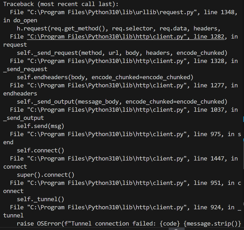

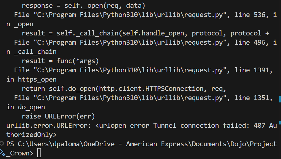

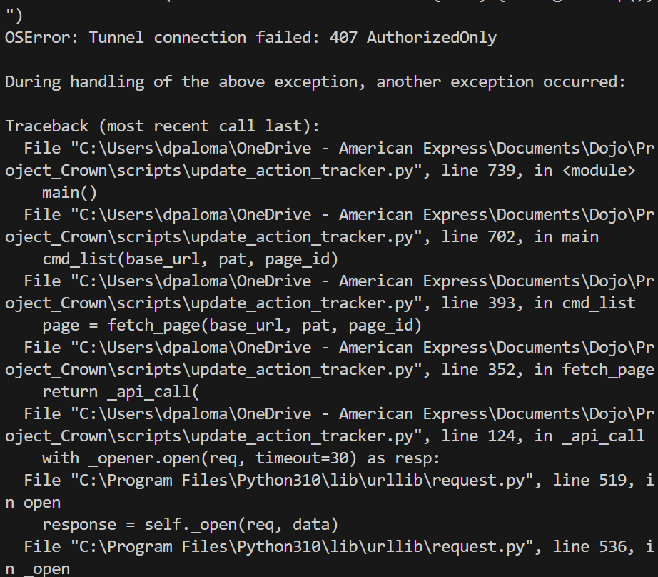

Hi Team,
Please find additional evidence from the automation call.
I ran:
.\.venv\Scripts\python [update_action_tracker.py](http://_vscodecontentref_/2) list
Result:
urllib.error.URLError: <urlopen error Tunnel connection failed: 407 AuthorizedOnly>
This indicates the request is blocked at the corporate proxy tunnel (HTTP 407) before the Confluence API can be reached.
Could you please verify/reset my ADS/proxy authorization and allow outbound proxy access for:
I’ve attached screenshots of:
  1. direct Invoke-WebRequest test
  2. automation traceback showing 407 AuthorizedOnly.
ThanksScreenshot 2026-08-11 090835.pngScreenshot 2026-08-11 090806.pngScreenshot 2026-08-11 090732.png
