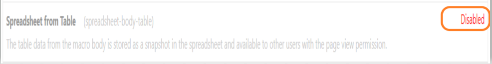

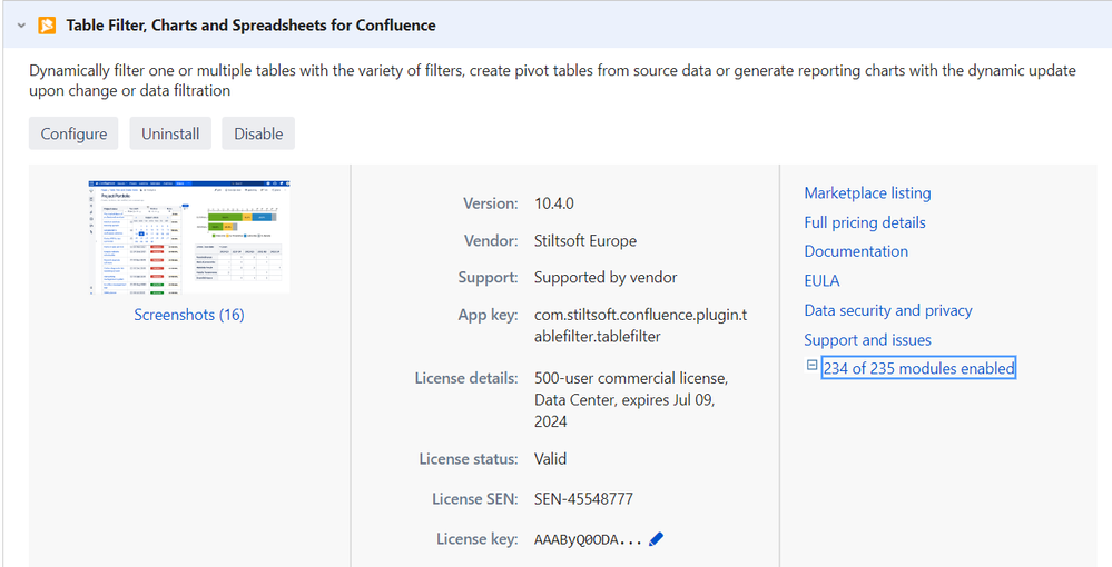

* When I discussed this with my users who have reported this they only stated behaving this way after upgrading the "Table Filter, Charts and Spreadsheets for Confluence" version "10.4.0" which is the latest marketplace version as a part of our Confluence LTS upgrade to 7.19.18.
* In the plugin manager I can see one module named "Spreadsheet from Table" that shows as disabled.
* Does this make any impact on the performance of the app?
*Please see the screenshot attached.

If you think that the slowness began after the update, you may refer to our support - we are not aware of any performance issues for the 10.4.0 version. So, we'll be able to discuss the issue more via the confidential portal.
By the way, the current version is 10.5.0, you may update the app as well.
What concerns the inactive module, it has nothing to do with the issue that you describe. It only means that the Spreadsheet from Table macro is disabled by default and you need to enable it manually if you want your users to use it in your instance.
You can read more about the Spreadsheet from Table macro here.
