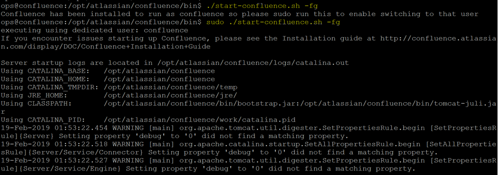

When start Confluence, noticing the below error:
@Confluence:/opt/atlassian/confluence/bin$ sudo ./start-confluence.sh -fg
What this error means and how to resolve the below error. It helps to troubleshoot. Any  suggestion are welcome.
HTTP Status 500 - java.lang.IllegalStateException: Spring Application context has not been set

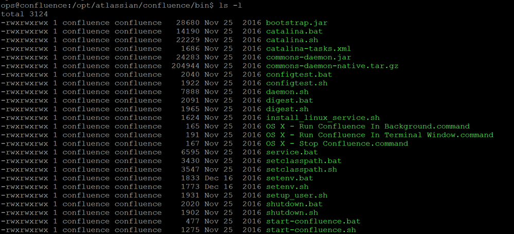

Actually, I tried changing the ownership permissions of my "confluence" user. When running the confluence start/stop commands, still requires sudo permission. Please help, what to do now - I'm new to confluence setup. (trying to troubleshoot the existing setup, Installation and configuration setup has done by another engineer earlier)
Start Confluence:

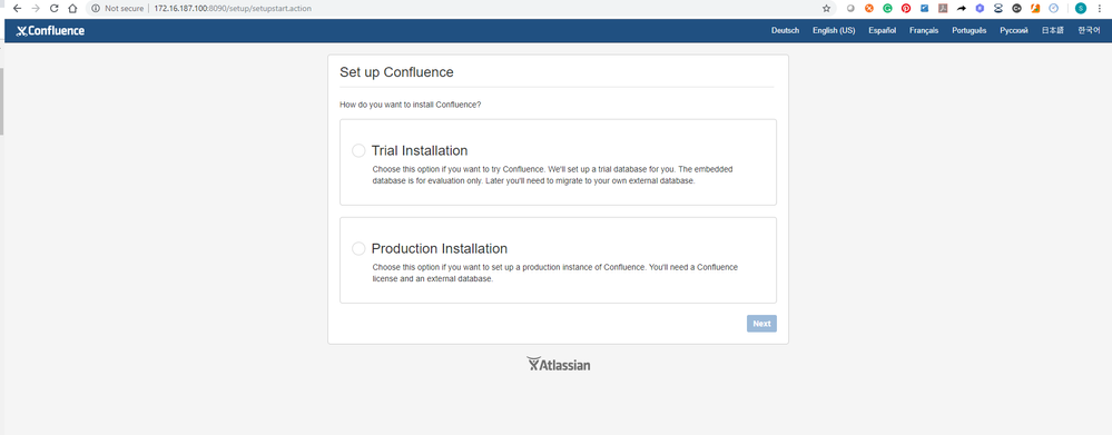

After starting Confluence, Im getting setupstart.action page as below:
sahanajsj
February 19, 2019
I used these commands to change the permissions:
$ sudo chown -R confluence.confluence /var/atlassian/application-data/confluence
$ sudo chown -R confluence.confluence /opt/atlassian/confluence
$ sudo chmod -R u=rwx,go-rwx /var/atlassian/application-data/confluence
$ sudo chmod -R u=rwx,go-rwx /opt/atlassian/confluence
Kiran Panduga {Appfire}
February 19, 2019
Hi @sahanajsj ,
setupstart.action page indicates that the Confluence has started, now you just need to complete the installation steps and configure your database schema
After which you should be able to login and access the Confluence instance.
Thanks,
Kiran.
sahanajsj
February 19, 2019
Thanks for the reply, but I wonder these installation steps configurethe confluence newly? or will i able to get the earlier configured setup which has my data and files.
sahanajsj
February 19, 2019
@Kiran Panduga {Appfire} Im not clear at this point of installation, its like a new installation of confluence and configure to my existing/old Database?
How it works, can please brief me.

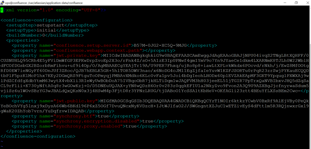

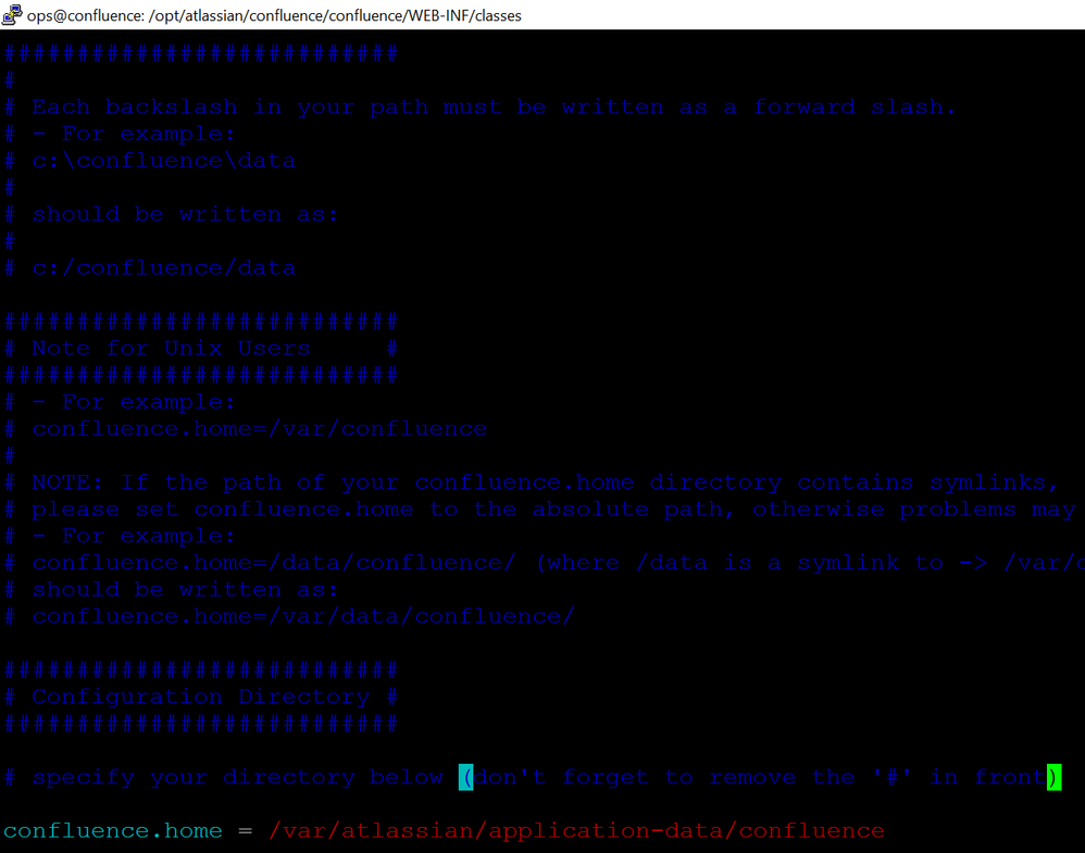

@sahanajsj  Can you check if the home directory is pointing to the correct path by validating the below configuration file ?
/opt/atlassian/confluence/Confluence/WEB-INF/classes/confluence-init-properties
Also, verify the confluence.cfg.xml file in the home directory /var/atlassian/application-data/confluence, it should have reference to your old database schema.
If this file is missing, it will create new confluence.cfg.xml file and due to which new installation is starting.

sahanajsj
February 19, 2019
I verified the configuration file, it seems pointing properly to home-directory
In confluence.cfg.xml file, im not seeing any database schema related.
Now, what are the ways to look for existing database Schema or to configure again to retain the data without any loss.?
Please suggest.
February 19, 2019
Hi @sahanajsj ,
I'm afraid, now there are only two options to retain the existing data.
  • Do you have a copy of your old home directory ? If so, you can restore it.
(or)
  • If you were using MySQL database schema, then try adding the below parameters into the confluence.cfg.xml file to point to your existing database and then restart the Confluence. It should bring up the old data.
{code}
<property name="hibernate.connection.driver_class">com.mysql.jdbc.Driver</property>
<property name="hibernate.connection.password">confluencepass</property>
<property name="hibernate.connection.url">jdbc:mysql://<servername>/<databasename>?autoReconnect=true</property>
<property name="hibernate.connection.username">confluencedbuser</property>
<property name="hibernate.database.lower_non_ascii_supported">true</property>
<property name="hibernate.dialect">com.atlassian.hibernate.dialect.MySQLDialect</property>
{code}
For more information, refer to the below KB article
https://confluence.atlassian.com/confkb/how-to-find-confluence-s-database-connection-parameters-779172320.html
