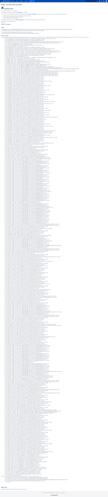

When I tried to access the list of users: I got this Error,
Cause
org.springframework.dao.IncorrectResultSizeDataAccessException: query did not return a unique result: 2; nested exception is org.hibernate.NonUniqueResultException: query did not return a unique result: 2
    at org.springframework.orm.hibernate5.SessionFactoryUtils.convertHibernateAccessException(SessionFactoryUtils.java:256)
caused by: org.hibernate.NonUniqueResultException: query did not return a unique result: 2
    at org.hibernate.query.internal.AbstractProducedQuery.uniqueElement(AbstractProducedQuery.java:1483)
Stack Trace:[hide]
	at org.springframework.orm.hibernate5.HibernateTemplate.doExecute(HibernateTemplate.java:362)
	at org.springframework.orm.hibernate5.HibernateTemplate.execute(HibernateTemplate.java:313)
	at com.atlassian.confluence.user.persistence.dao.hibernate.HibernateConfluenceUserDao.findByUsername(HibernateConfluenceUserDao.java:71)
	at com.atlassian.confluence.impl.user.persistence.dao.CachingConfluenceUserDao.findByUsername(CachingConfluenceUserDao.java:82)
	at sun.reflect.GeneratedMethodAccessor611.invoke(Unknown Source)
	at sun.reflect.DelegatingMethodAccessorImpl.invoke(DelegatingMethodAccessorImpl.java:43)
	at java.lang.reflect.Method.invoke(Method.java:497)

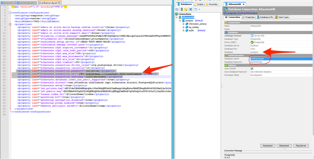

Basem Abdulrahem
March 12, 2018
Hi Ann,
I got it, Thanks..
But, here we are... I didn't find users' table!! Did I search in the wrong place?
Many thanks,
Basem

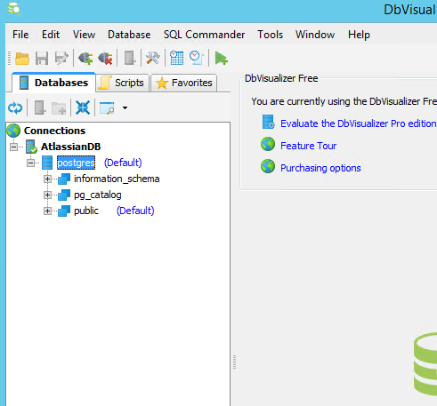

AnnWorley
March 12, 2018
Hi Basem,
The only database I see under the PostgreSQL database connection in the screen shot is the default postgres database that is installed with PostgreSQL. I do not see another database dedicated to Confluence. Maybe the connection is to a different PostgreSQL instance?
Please examine your <confluence_home>/confluence.cfg.xml to double check the PostgreSQL server and database names, for example:
<property name="hibernate.connection.url">jdbc:postgresql://Servername:port/confluence_database_name</property>
Then use the username and password to connect in DB Visualizer:
 <property name="hibernate.connection.username">yourDBuser</property>
 <property name="hibernate.connection.password">db_password</property>
 The cwd_group table can be queried for duplicates once you connect to the database Confluence is using.
Please let me know how it goes.
Thanks,
Ann
Basem Abdulrahem
March 12, 2018
Hello Ann,
I already did. I logged in by the confluenceuser and the password which I found in the xml file.
Thanks,
Basem

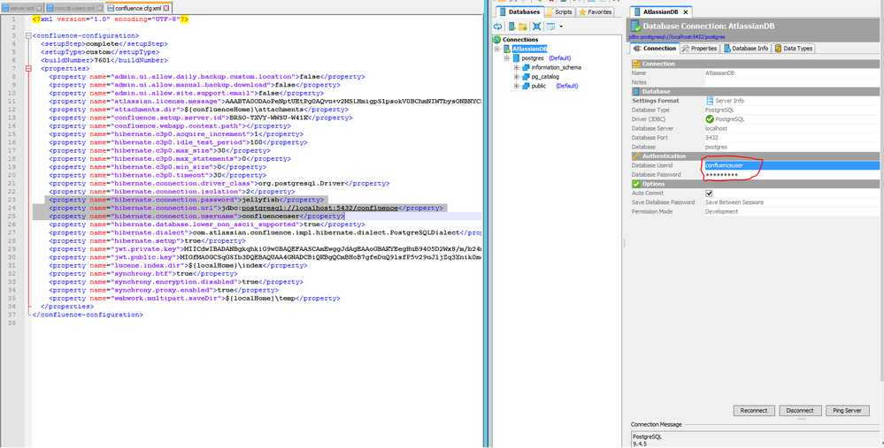

AnnWorley
March 12, 2018
Screen shots are a great help, thank you.
I think the database needs to be confluence instead of postgres:
Basem Abdulrahem
March 12, 2018
Many thanks Ann. I really appreciate your help. I managed to connect and edit the record which cause this conflict.
Regards,
Basem
