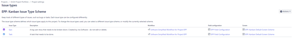

I cannot associate Issue two Type Schemes with one project to separate epics and tasks
Alibek Zhubanyshev
November 27, 2024
here I want to have two different issue Type Schemes for epic and task, because we need to have different layout and screens, etc for them

Alibek Zhubanyshev
November 27, 2024
when I try to do step "new issue type scheme with the desired issue and associate it with the project." for tasks, Jira asks me to convert existing epics to tasks. I need one type scheme to tasks and separate type scheme for epics.

Alibek Zhubanyshev
November 29, 2024
Thank you!
I did it for screen
upd: ok I needed just to associate existing scheme with new configuration. Thanks!

Marc -Devoteam-
November 27, 2024
Hi @Alibek Zhubanyshev
This is not depended on the issue type scheme, but based on the screens, screen schemes and related config of the issue type screen scheme.
For issue type flow this is related to the workflow and the workflow scheme.
For field visibility and required fields this is based on field configurations and the field configuration scheme.
The issue type scheme only defines what issue types are available on the project not the  configuration of the issue type in relation to layout and flow
