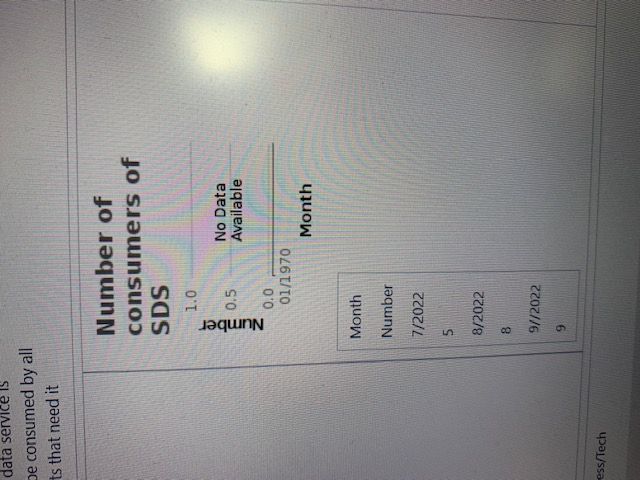

I am trying to chart one data series across months,  a line chart - I'm not sure how to format the table so that the macro reads it correctly. i keep getting the error 'no data found'. See picture below

Matt Reiner _K15t_
Atlassian Partner
October 26, 2022
@CatherineP

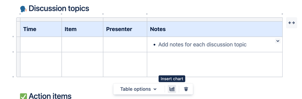

It looks like you're using the old Chart macro (which I hope is going away). To use the new chart feature, you should be able to select you table, and then in the table options menu, you can select "Insert Chart".
Does this work for you?

CatherineP
October 26, 2022
Thanks This sounds a lot simpler but I can't seem to access the Table options menu  !
Katerina Kovriga _Stiltsoft_
October 26, 2022
It seems that you are using an old legacy editor. Please give us a screenshot of your source table in the page edit mode with the headers visible. We'll try to advise.
