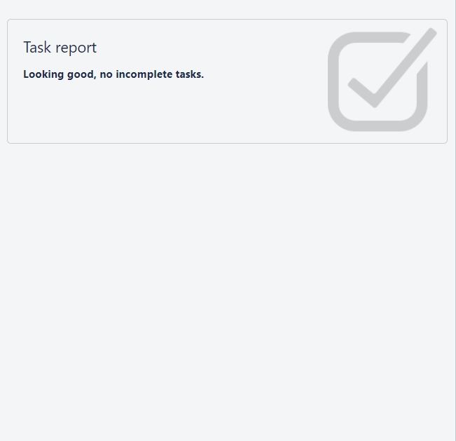

Stian Espe
May 23, 2019
Hi! Trying to get your brilliant tip to work, however i only get the following output when following your guide, any idea?
- I do have task assigned to myself
- After changing the source to the below, the task report is empty.
<ri:user ri:userkey="$action.remoteUser.key"/>
Davin Studer
May 23, 2019
You can't do it by changing the source. You need to create a user macro. The source editor is simple to set the macro up the way you want initially and then to get the storage format for that setup. The user macro will then do the work of dynamically swapping out the user piece for you. By changing the source you are telling the macro to literally show tasks for the user "$action.remoteUser.key" ... which of course that user doesn't really exist.
Like Stian Espe likes this

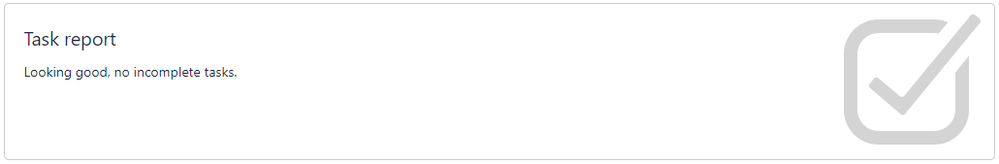

Sam Yil
July 31, 2023
Hi @Davin Studer
is there a workaround or another approach for DataCenter? We use Confluence DataCenter (7.19.9) and this unfortunately does not work for us. I don't get any result(enough tasks are available, different & same space, page..). Configured as you specified..
Thanks in advance!
Sam
