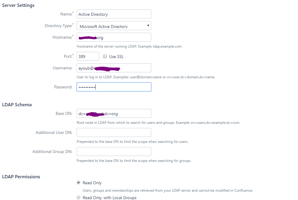

JP _AC Bielefeld Leader_
November 12, 2018
Could you post your Jira AD configuration? Is it exactly the same? I suggest, adding User & Group DN to filter on them. How many users are in the AD?

Ahmed Ayoub
December 6, 2018
Sorry Jan, this went to my Junk Mail and I gave up on it  as it was not a priority...
But let me post you my AD configuration...:

 what i dont understand is that i did the same thing i did in Jira Service Desk.. there it did not create any issues for me..
Thanks again for looking into this..
Ahmed Ayoub
December 6, 2018
i did do that, same problem.
569 Users
Ahmed Ayoub
December 6, 2018
Oh, i only bought the starter license - if that has any effect ...
