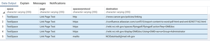

I took the example page you provided and re-created it within Confluence to test the SQL query. I found running the SQL query as following provided a result as shown below:

With this information, the query looks to be working along with results being returned as expected. If you’re not getting the results as above, there may be a database issue or query issue causing the information not to return properly.
