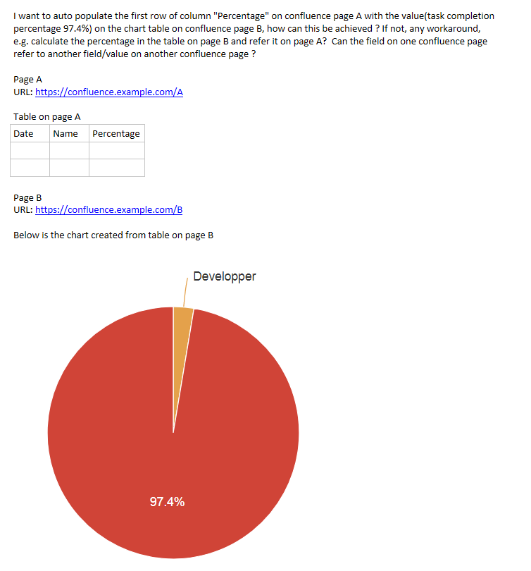

I want to auto populate the first row of column "Percentage" on confluence page A with the value(task completion percentage 97.4%) on the chart table on confluence page B, how can this be achieved ? If not, any workaround, e.g. calculate the percentage in the table on page B and refer it on page A?  Can the field on one confluence page refer to another field/value on another confluence page ?
Page A
URL: https://confluence.example.com/A
Table on page A
Date
Name
Percentage
Page B
URL: https://confluence.example.com/B
Below is the chart created from table on page B

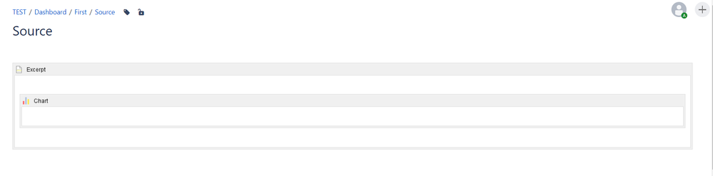

Aleksandr Zuevich
February 12, 2019
Will, take a look into the next picture. I just place Chart macro inside Excerpt:

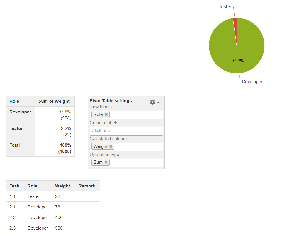

Will Wang
February 12, 2019
Hi Aleksandr,
    I used the chart from table&pivot table which was generated based on one table on the same page, have tried, can embed chart into excerpt but can't embed "chart from table" into excerpt.  Below is the pivot table generated, any way to embed value(97.8%) of developer displayed on"chart from table" or "pivot table" into excerpt ?

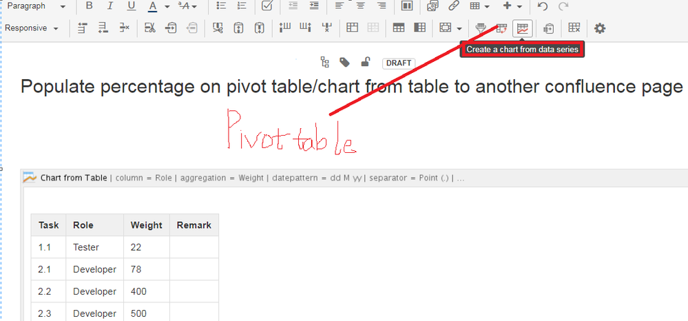

Will Wang
February 13, 2019
Hi Aleksandr,
   Kindly refer to first capture for pivot table&chart from table button on confluence page, refer to second capture for the source data(sample data only, but is very similar to our actual data) and related pivot table&chart from table.
      pivot table_chart from table button.PNGPivot table_Chart from table data.PNG

Aleksandr Zuevich
February 13, 2019
Hi Will,
As I see Pivot table and Chart are dynamic content, which is generated in VIEW mode. So you don't have possibility to refer them at other page.
@Andrey Khaneev _StiltSoft_, it looks like a good feature request - to add possibility to refer table values on another page, not just table inside macro body as it is now. (like it done in https://marketplace.atlassian.com/apps/1212655/celestecs-math-for-confluence)
February 14, 2019
Hi Will,
Yes, you can use Excerpt Include macro to place the Pivot Table macro on another page and filter it, so there will be a table with only two cells: "Sum of weight" and "97.8%".
