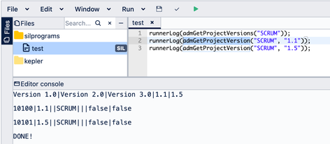

There's nothing on the stored data that will tell when a version was added, so I don't know if there's a reliable way to tell which version was recently added.
Considering how DB works we may assume larger ID values are more recent (I wouldn't call that bulletproof, but it may work on most cases).
Then you may choose to work with admGetProjectVersions and admGetProjectVersion to get the version with the higher ID (first field from admGetProjectVersion).
In this example I would assume 1.5 is the more recent version based on the ID (10101).
https://confluence.cprime.io/display/SIL/admGetProjectVersion
https://confluence.cprime.io/display/SIL/admGetProjectVersions

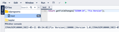

If you need to check the latest value assigned to a Jira Issue, then you may use getFieldChanges .
The below will get all the changes applied to the field.
getFieldChanges("SCRUM-14", "Fix Version")

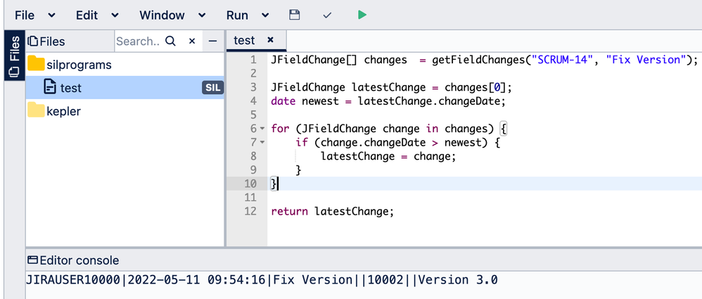

The below script will get the latest value for the same field.
JFieldChange[] changes = getFieldChanges("SCRUM-14", "Fix Version");
JFieldChange latestChange = changes[0];
date newest = latestChange.changeDate;
for (JFieldChange change in changes) {
if (change.changeDate > newest) {
latestChange = change;
return latestChange;

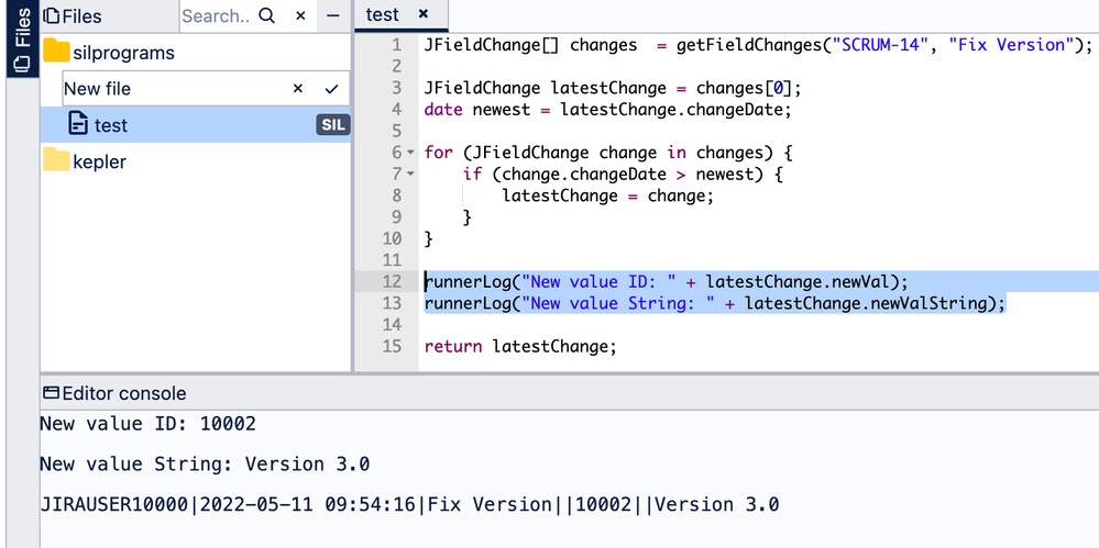

How to get version name? For further actions with the script, we need to pull out the version name. For example, set the variable:
string lastVersion;
and assign the resulting value to it, in your example it is "Version 3.0"
Thiago Masutti
May 11, 2022
Hi Ellen.
That returns a JFieldChange object. The structure is detailed in https://confluence.cprime.io/display/SIL/Predefined+structure+types#Predefinedstructuretypes-JFieldChange
You may use one of the following depending on what you need.
latestChange.newVal
latestChange.newValString
