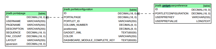

I think you should try to do that via the database. All gadgets on all dashboards are storing their preferences in the database.
It means that:
  1. re-configure one feeder page manually so that you have an example
  2. check out the gadget preferences of this page in the database
  3. based on that, write an SQL UPDATE statement and update all other gadgets
This is the theory. I'd experiment with this in a staging Jira so that I don't destroy all dashboards accidentally, and only if I have a proven recipe, I'd run that on the production database.
Database tables are documented here: https://developer.atlassian.com/server/jira/platform/database-schema/
Note that in the old terminology dashboards are called "portal pages" and gadgets are "widgets", therefore you should probably focus on these tables:
