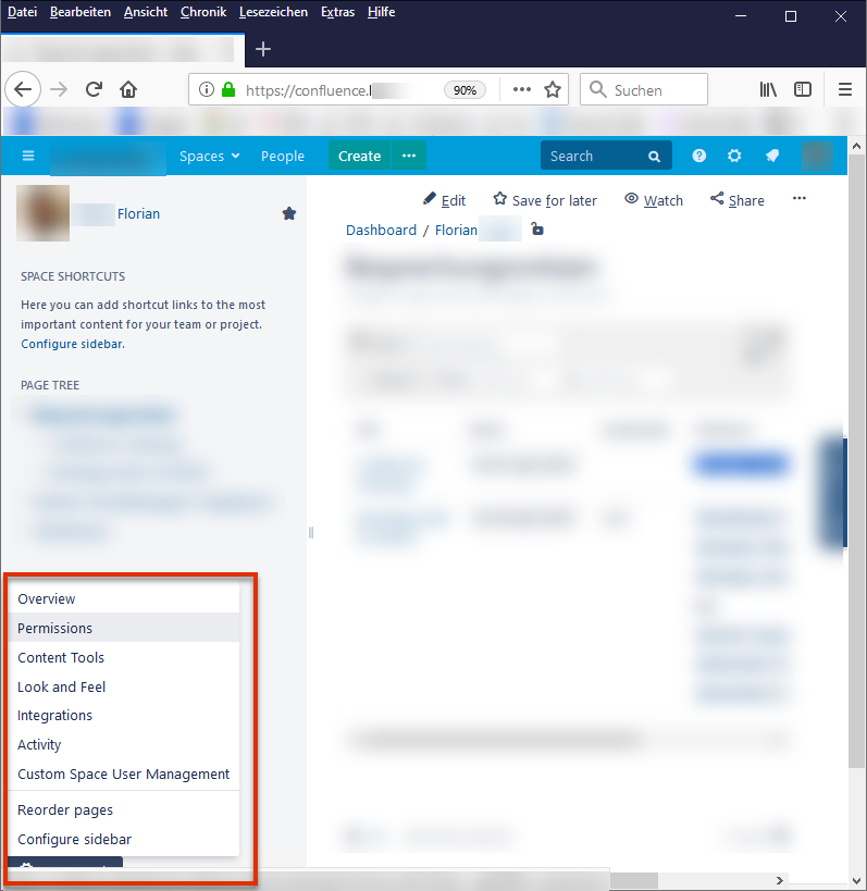

Suren_Ratti
April 29, 2020
Hi Florian! Thanks for your reply. Can you please guide me on how did you open that pop menu? I don't see any option on my end of SERVER based platform.
Florian
May 4, 2020
Hi Suren,
it's in the lower left corner.
Cheers
