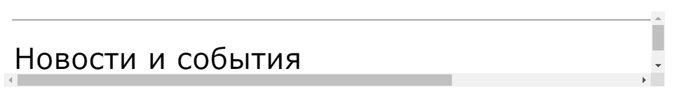

I need help with adaptation of draw io on Confluence.
When I change the scale of the page there are scroll lines appears:
How I can avoid it and make diagram resizable to scale?

Hi @Анастасия Епифанцева
The drawio viewer is not a responsive element. It should resize correctly when you refresh the Confluence page. When you refresh, do you still see scrollbars, please?
Thanks,
Marija
Do you mean there is no way to adopt it to size?
I tried to do it with pictures, I changed px on %.
Yes, when I refresh the page, it is the same
Marija Radovic
August 11, 2021
Thanks for the reply. If you still see scroll bars after page refresh please submit all the details to: https://drawio.atlassian.net/servicedesk/customer/portal/14/group/15/create/49
so we could investigate this additionally.
We need:
* Confluence Server version and draw.io version
* browser version and operating system
* storage format of the Confluence page in question (three dots top right > View storage format)
* draw.io diagram file in question (not diagram png file) so we could test it (three dots > Attachments)
Thanks,
Marija

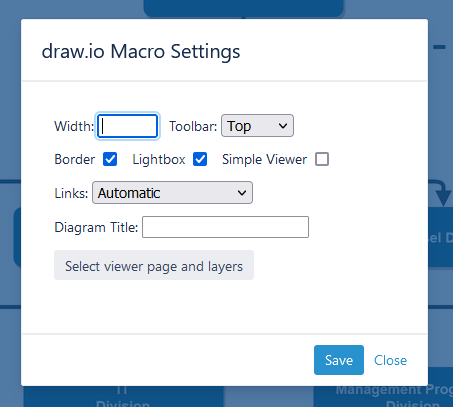

Hi @Анастасия Епифанцева,
when in Page Edit mode you can click on the macro and than choose "Edit Macro".
Try to enter a width that fits your need. Also try "Simple Viewer" instead of Lightbox.
Kind regards,
Svenja
Hello @Svenja Lorenzen !
Thanks for your answer.
I tried it. But it will change in same way if change the scale. I need that it was correct, because a lot users read my page with different scales.
