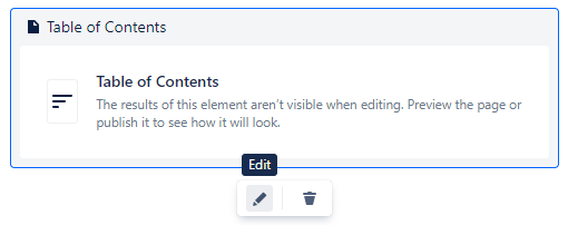

For me, enabling the table of contents "printable" option caused this. Disabling it fixed the issue for me. You will find this setting by going into the edit for TOC.
I didn't need to have the TOC in the final export, so that was acceptable on my part. If you need to have a TOC, you can try replicating it using macros.
I hope that helps.
