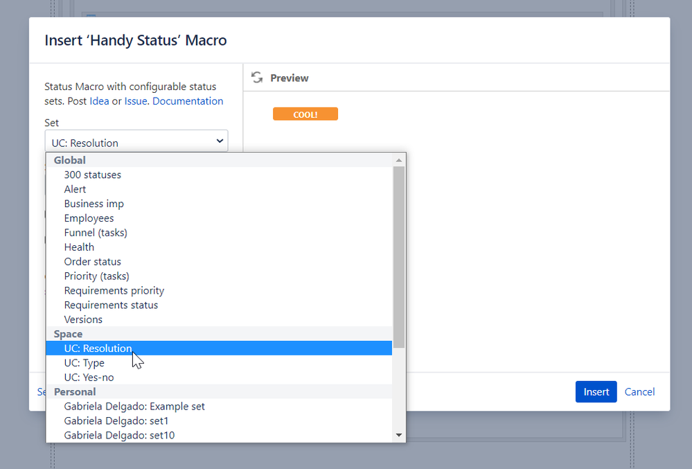

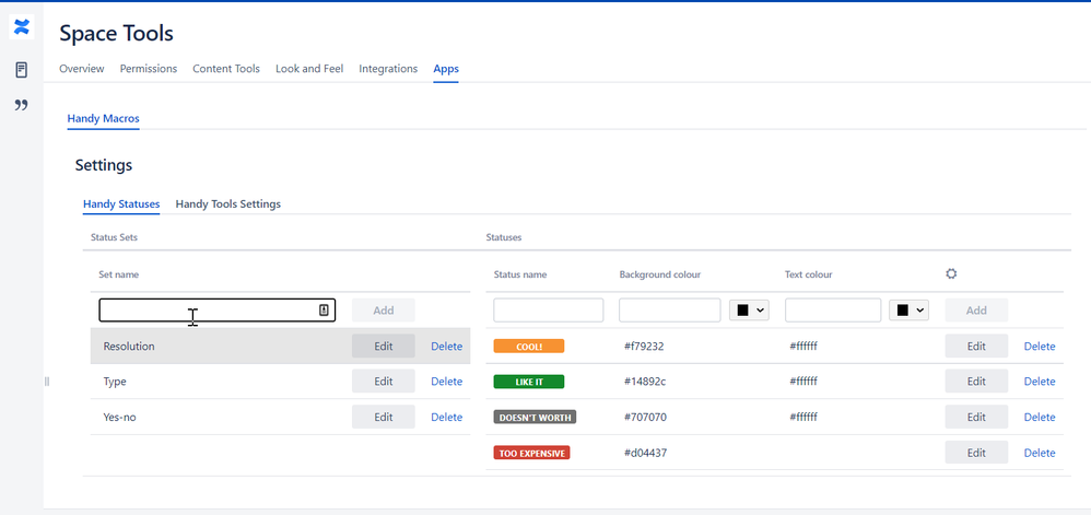

You need to be a space administrator to add status sets to spaces in the space tools:
Space status sets looks the following way:
