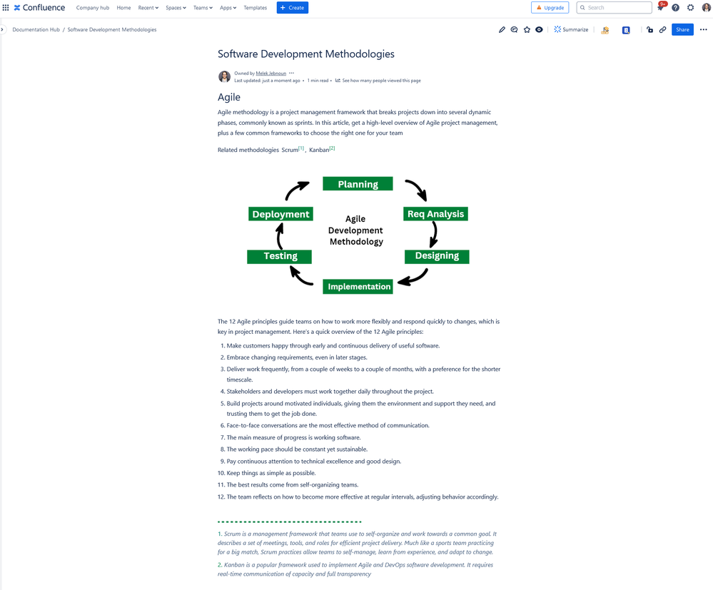

In that case, you should opt for a third party App! I advice to have a look at our App https://marketplace.atlassian.com/apps/1212124/content-formatting-toolkit-for-confluence It contains a specific Footnote macros to list all your footnotes with advanced look and feel configuration. (Below an example on how it looks on Confluence pages)
