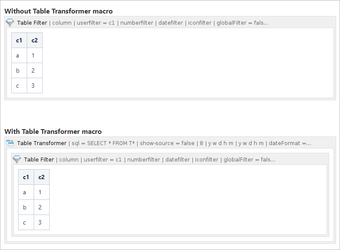

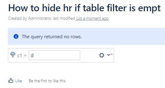

I can suggest wrapping your Table Filter macro into the Table Transformer macro:
So when you don't have any suitable rows to display, you'll get a blue info message that there are no any rows returned (not the empty table header row as you had before).

I was looking for a solution to avoid the display of the empty table header row if the filter conditions are set too restrictive. I found your solution, to wrap the Table Filter macro with a Table Transformer macro and it's a great solution. BUT:
Now the table filters are no longer displayed above the table, but below it.
This is also visible in your example (see screenshot). Since my table is rather long, this is not an acceptable solution. How can this be avoided?

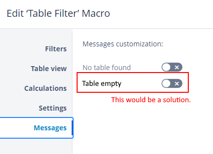

To my experience this irritates users. I'd prefer a displayed message. Unfortunately it is currently not possible to configure this in the Table Filter macro.
An additional option like in the screenshot below would be a solution:

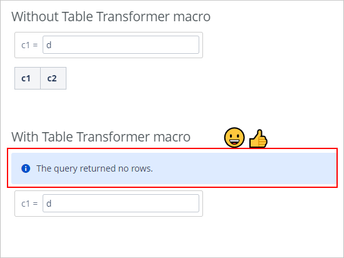

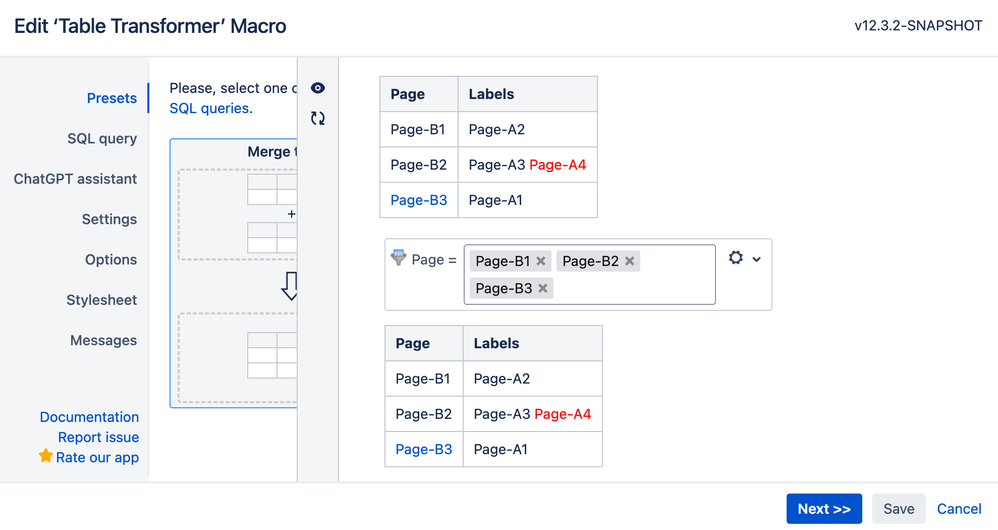

Maybe we weren't clear about the workaround:
Here is a screenshot taken when we choose to Show all content in the Table Transformer macro.
The header is your original table when the filters are too strict and there are no any rows. It comes from the Table Filter macro.
The filtration panel comes with the original table and also belongs to the Table Filter macro.
The blue message is an output of the Table Transformer macro. And the output of the external macro is always on top.

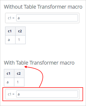

If the filters are not strict, we will have the same view but with the whole table:
By choosing the Hide tables option in the Table Transformer macro we hide the original table coming from the Table Filter macro (and it is the second lower table!).
So, on top we have the table coming from the Table Transformer macro. Below it we still have the filtration panel from the Table Filter macro.
The filtration panel remains until we choose the Hide all content option.

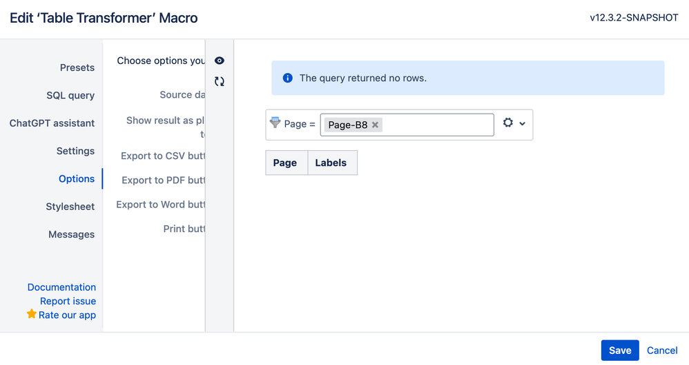

Thank you for the detailed explanation of how it works. I hadn't actually thought about the Source data option. This was set to "Hide tables" (apparently the default value).
So the table that is displayed with this setting is the output of the Table Transformer macro. This was not clear to me and of course explains why the filtration panel is displayed below the table. And also why filters in header were not displayed in my case.

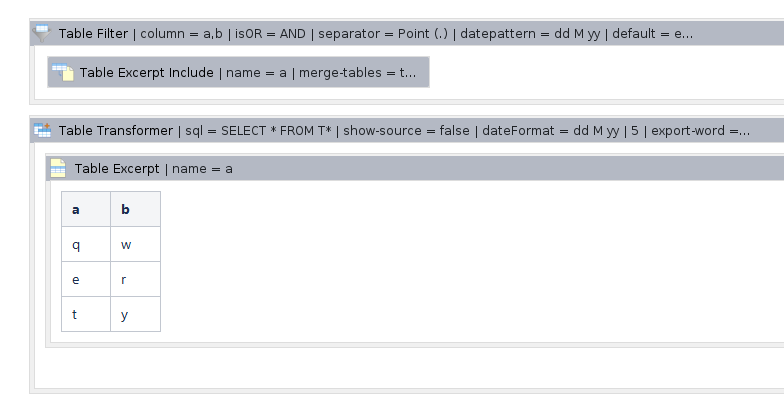

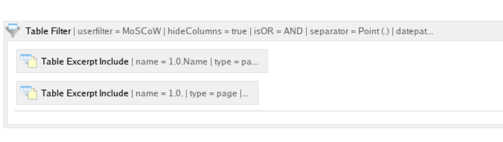

Hi @Ulrik Schoth ,
The following structure may help to keep the filtration panel above the table:
It seems to be rather overloaded though, so we've created a feature request for our internal roadmap - this ticket is linked to it, so we'll come back here with the updates when it's implemented.
