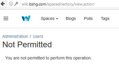

We are using confluence server. with version V6.2.4
We do totally the same as:
https://confluence.atlassian.com/confkb/how-to-grant-access-to-one-space-only-to-a-user-in-confluence-815244321.html
We did add both created group and individual user to target space. after all we see the created local user have no permission to any space.  The setting is not taking effort. but why...?

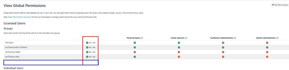

Grigory Salnikov
August 13, 2018
Ah, you seem to mix up something. According to this article
This is the most basic permission that allows users to access the site.
In other words, without this permission, the user cannot use the Confluence at all.
And that seems to be the point here.
Grigory Salnikov
August 13, 2018
Small addition.
Granting a user "can use" global permission doesn't mean that you grant him any administrative rights.

Feng Linjie
August 13, 2018
Hello, @Grigory Salnikov@Moses Thomas
Thanks for answering
Maybe I'm wrong, but if I add group to "can use" the group is having access to whole wiki. which is not what we want...

Grigory Salnikov
August 13, 2018

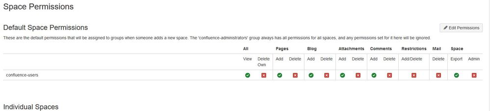

In some sense, yes, this permission grants access to wiki, but unless you specify the group on the space level permission, its members should have no access to the space.
I suggest you try and see what happens.
Moses Thomas
August 13, 2018
Strongly  agree with  Greg if you  don't add group in  the default space permission   and you did not give access to  individual  spaces ,  they  cannot  see other spaces  impossible.
Feng Linjie
August 13, 2018

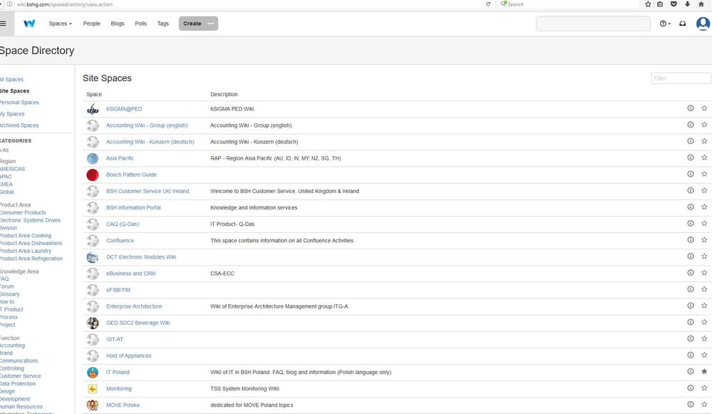

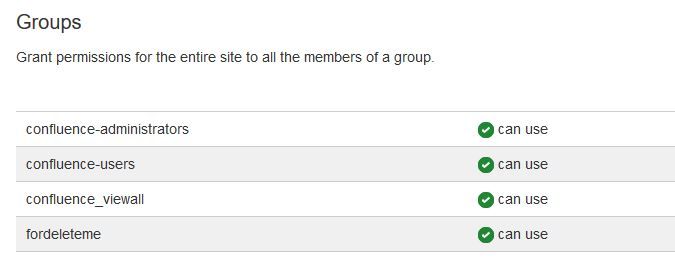

Hello
Did you see my screenshot? I give "fordeleteme" "can use" permission on site level, give it read permission to one space, then I login to wiki, see actually the functional account able to see the whole wiki site. which is not correct.
Tell me if I didn't tell the fact correctly.
Many thanks!
Feng Linjie
August 13, 2018
Sorry, I think I found the root cause. I was not aware so many space owners set their spaces with “anonymous access”. which puzzled me.
Now issue fixed, many thanks.

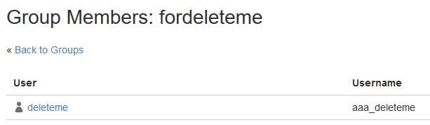

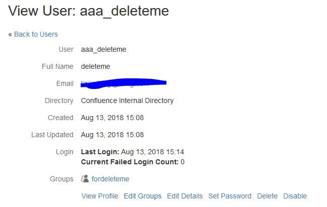

Hi
We did the following:
1. create a new account
2. remove it from confluence-users group
3. create a new group and add the account inside the group
4. give both group and account read permission to one space
5. login with this user, find no permission
Grigory Salnikov
August 13, 2018
Then, as @Moses Thomas has suggested, make sure that this group also has "can use" global permission":
Feng Linjie
August 13, 2018
No, it should not be can use on global level, otherwise it will have permission to all spaces.
Grigory Salnikov
August 13, 2018
No, unless you add this group specifically in the space permissions.
