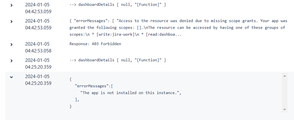

I am getting the below error:
"errorMessages": [
"The app is not installed on this instance."
Do you have any idea how to resolve this issue.

as you mentioned above changes have done on my code still can't get the success logs on rest api.
this my forge code am getting this type response while deployed on server.
Hey @Arun
In the logs I see the 403 forbidden access. Not sure why is this showing to you. Also another thing

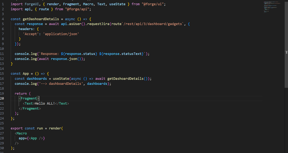

My requirement is to display the dashboard gadget's in confluence page therefore we trying to get the dashboard api details through forge app.
Hey @Nikola Perisic
I have attached the work image that's what am trying with NodeJS on that time. I had tried with the forge app using the get api also getting the same error .
