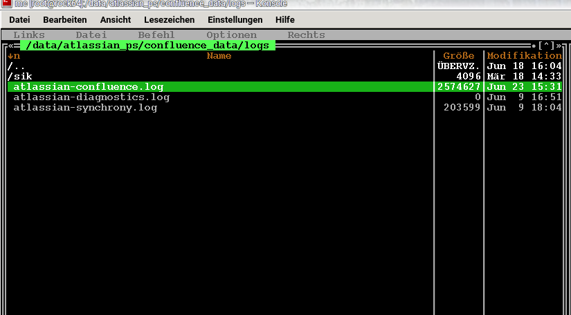

You can find the error code in the log file atlassian-confluence.log.
This is located in the data directory under ../logs

The path in which the confluence is installed is different for you.

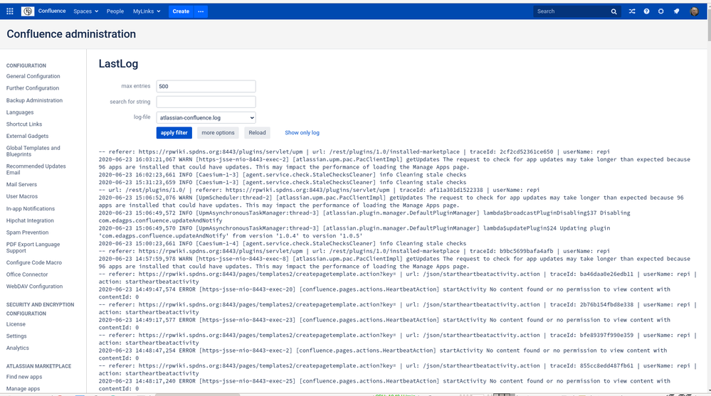

Download this app and you can view the log from confluence.
https://marketplace.atlassian.com/apps/1216685/last-log-for-confluence?hosting=server&tab=overview
