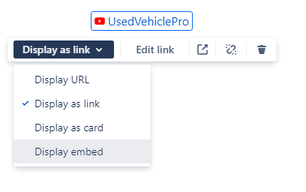

Hello, it is quite simple to embed a Youtube video in Confluence, just follow, the steps below.
1. click on the link icon on the toolbar
2. paste your link
3. click on the link which you just pasted
4. A toolbar should pop up, click on "Display as link" on the drop-down, select Display as embed, and that's all.
Jenn Ferreris
August 17, 2021
I am unable to see Display embed.  I wonder if there is another way since I'd like for the video to be shown. When using the widget mentioned at the beginning of this thread, it says you can adjust the size.  For me, I cannot.  Also, I cannot go into fullscreen unless I tap the YouTube icon.
