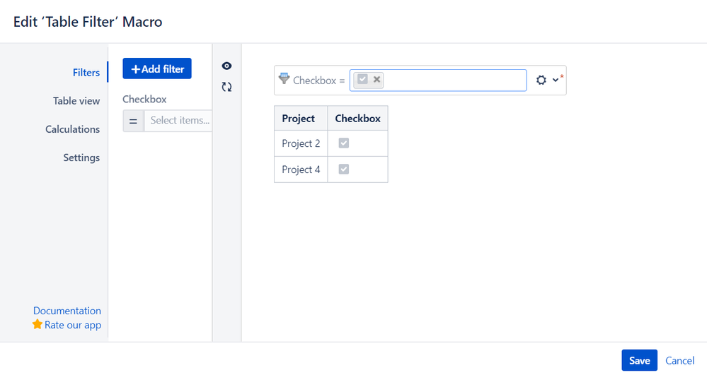

Our macros understand the checked and empty checkboxes, please see the screenshots below related to the Table Filter macro:
What concerns the Table Transformer macro, please refer to the cells with checkboxes as “Completed” and “Incomplete” for your CASE WHEN queries.

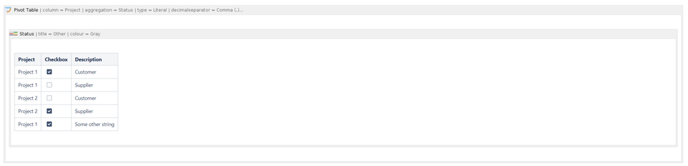

The Table Filter and Pivot Table macros understand the whole task (checkbox+description) as a whole thing and operate with it in terms of checked and unchecked item. The description itself is not taken into consideration, only the state of the checkbox is important.
But the Table Transformer macro is a bit tricky: to consider checkboxes and descriptions separately, you need to have them into separate cells (one checkbox per cell). But if you try to split the checkbox from the description via the SQL query, the checkbox won't be recognized and the query will be working with your description (as with the string, I mean).

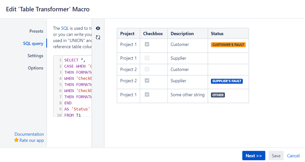

So, to achieve your case, you may reorganize the table structure and keep your checkboxes and descriptions separately (a separate cell for each item). Please see an example below:
Then you'll be able to check both the state of the checkbox and the contents of its description. The query may look like this, for example:
SELECT *,
CASE WHEN 'Checkbox' = "Completed" AND 'Description' LIKE "%Customer%"
THEN FORMATWIKI("{status:colour=Yellow|title=Customer's fault}")
WHEN 'Checkbox' = "Completed" AND 'Description' LIKE "%Supplier%"
THEN FORMATWIKI("{status:colour=Blue|title=Supplier's fault}")
THEN FORMATWIKI("{status:colour=Gray|title=Other}")
END
AS 'Status'
FROM T1

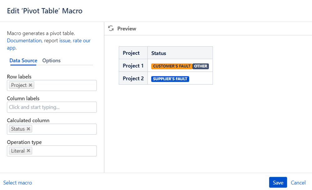

Then you may use the Table Filter macro or Pivot Table macro on top of the Table Transformer macro to filter/aggregate your projects by statuses:
Hope this workaround helps your case.

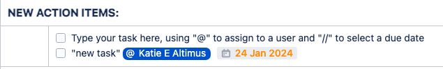

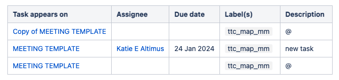

@Katerina Rudkovskaya [Stiltsoft] I have a question related to your answer.
How does this apply when the Table Transformer is wrapping a "Task Report" macro?
For example, I wanted the description to be just a string, so I use this SQL
SELECT
T1.'Task appears on',T1.'Assignee',T1.'Label(s)',
MATCH_REGEXP(T1.'Description',"(?<=\")[^\"]*","u") AS 'Description'
FROM T1

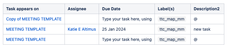

This shows the same as a Task report, but my "Description" column now only has the text between "". (Like [] "Katie's Task" @katie ///date will now display Description only as "Katie's Task")

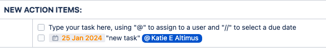

BUT the due date is no longer formatted nicely with a color indicating how soon it is due. Is there way to pull the due date from the description instead and keep the color scheme?
I tried re-ordering my tasks with the due date at the front, using SQL on "description" column to capture everything at the beginning. This does pull out the date, but it loses the knowledge that it is a "task" so it loses the formatting. Is there a way to trick the output to knowing it is a task still so that it doesn't lose the formatting?
Any tips are welcome!
Katie
Stiltsoft support
Atlassian Partner
January 25, 2024
Hi @Katie A ,
Unfortunately, the Table Transformer loses the formatting if the data was modified. If you just select the column, it stays. But if you do smth with the column, is disappears.
You may use another Table Transformer on top of the first one and format your dates (color the background) using the FORMATWIKI function and comparing dates with, for example, "today".

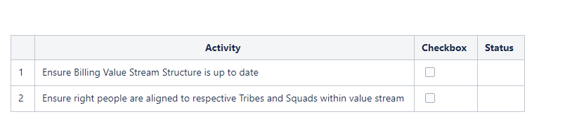

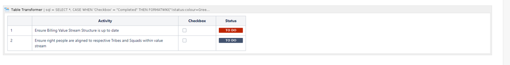

Hi @Stiltsoft support ,
It is losing the formatting anyway I tried this as what you mentioned above with Table Transformer..
I cant see it is updating the Status.
SELECT *,
CASE WHEN 'Checkbox' = "Completed" AND 'Activity' LIKE "%Ensure Billing Value Stream Structure is up to date%"
THEN FORMATWIKI("{status:colour=Green|title=Done}")
END
AS 'Status'
FROM T1

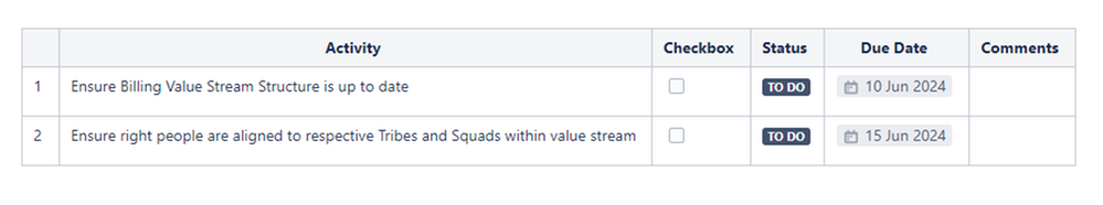

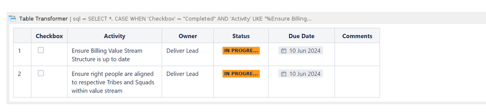

It is hiding the value of status column which was originally keyed in manually. if we add the Table Transformer macro.
Only in editing mode it is visible as given in second screen shot.
After marking  checkbox it is updating the status as Done but it will not be visible unless that page url is refreshed.
Yatiraj Sharma
June 12, 2024
I am adding a Status column as I need the Status Macro and I dont think SQL will add the status macro (It will add the columns and value in it....
But I am trying to address the issue as given my above screen shot, it will not show value even though status macro values are present in the column. And also, it will not show even though it is updated as "Completed" We have to refresh the page.
Any solution for these problems.

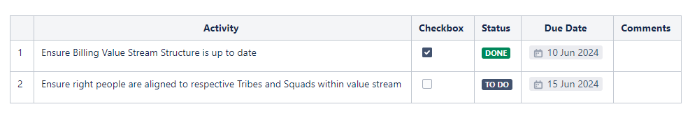

Thank you so much @Stiltsoft support , I am doing like below now
I will have status column only with Status macros in it if I would have not then SQL creates the column but does not add the status macros, (I tried refreshing it as well but it does not.)
Now I have below SQL
SELECT *,
THEN FORMATWIKI("{status:colour=Green|title=DONE}")
WHEN 'Checkbox' != "Completed"
THEN FORMATWIKI("{status:colour=Grey|title=TO DO}")
END
AS 'Status'
FROM T1

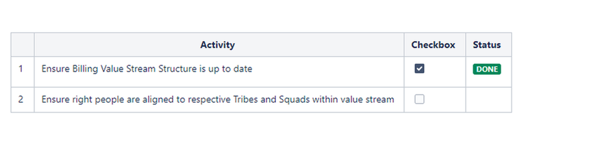

Which gives me result as below
Now if I check one of the box and refresh the page it gives me below
