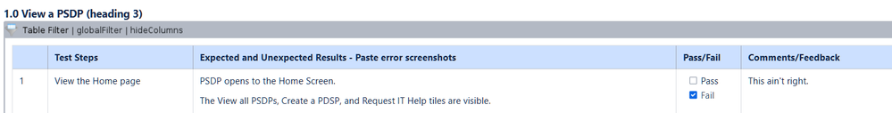

Have a table with a col containing a Pass check box (task list from Edit toolbar) and Fail check box.
Table is in the Table Filter macro.
How do I do a simple count of the Fail check boxes?

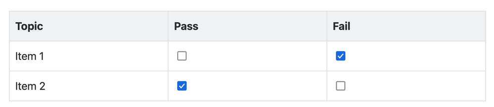

Do you have separate columns for each checkbox, like in the example below?
Barbara M Waxer
February 9, 2026
Thanks for getting back to me.
To your question, no, I inserted two task list check boxes in the same col.
If creating a separate col would allow me to count the Fails, I'll do that in a heart beat.

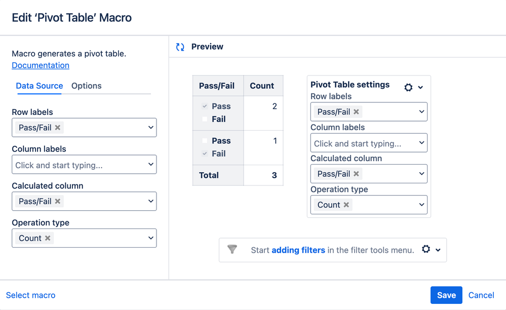

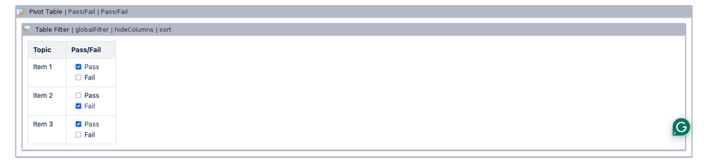

If you simply need to count how many "Fail" checkboxes you have, you can use our Pivot Table macro.
Namely, just wrap the existing Table Filter macro with the table inside the Pivot Table macro. And set the same settings as in the screenshot below. It should show you the exact number of "Fail" checkboxes.
Let me know if that helps 🙏🏼

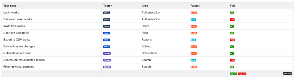

Clara Vega _Simpleasyty_
March 25, 2026
Hi @Barbara M Waxer ,
One possible way to approach this in Simple Table is to store the result as structured table data instead of relying on Confluence task checkboxes inside another macro.
For example, you could use a column like Result with values such as Pass and Fail, and then add a derived column like Fail to mark failed rows in a more report-friendly way.
That makes it possible to aggregate the result directly in the table footer and quickly see how many failed cases you have.
In practice, this approach is often easier to maintain because it also opens the door to things like:
  • fail totals by tester
  • fail totals by area
  • grouped summaries
  • cleaner UAT-style reporting directly in Confluence
For transparency: I work on Simple Table, so I’m sharing this as an alternative approach for teams that want to keep this kind of reporting inside Confluence.
