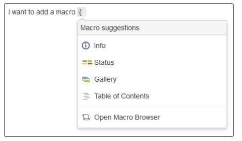

Anyone know how to change the customized macro name in the list of suggested macros (dropdown menu), which will be called by type "{" and the macro name?
I've tried add key/value pair on .properties file, like "groupid.artifactid.macroname.label = new macro name" , but not working.
Any ideas?
Thanks a lot :-)

Most macros are part of Confluence system plugins or third party add-ons. You would have to modify the plugin code to change the name that appears in the macro browser. Every time you upgrade you would need to do it again.
If the macro name you want to change is a User Macro, you may change it at Confluence Admin>User Macros>Macro Browser Information>Macro Name.

Thanks Ann. I made it by changing the macro name in atlassian-plugin.xml file.
