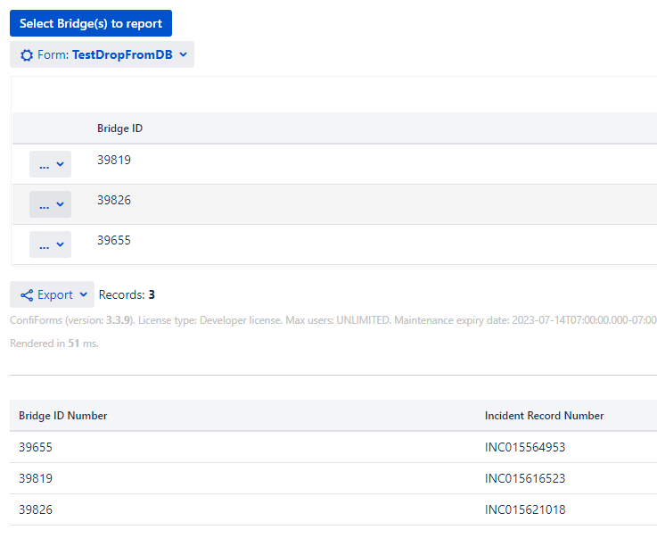

Randall Hinds
June 15, 2023
I've named my dynamic dropdown field BIDNumber , and it successfully queries the first column in this SQL:
Select brdg_id from eccdata.brdg_dtl
ORDER BY brdg_id ASC
These are all the fields in that particular table
brdg_id incdnt_no_tx brdg_type_id creat_user_id creat_ts lst_updt_user_id lst_updt_ts act_in ecc_init_brdg_in brdg_init_by_user_id miss_rsn_expl_tx miss_rsn_val_id proact_trgr_type_val_id slack_chan_thread_url_tx ecc_esclt_brdg_in slack_appl_esclt_ts slack_mjr_incdnt_mgmt_esclt_ts ecc_alrt_ntfy_ts triage_team_incdnt_no crcmvnt_ds prob_stmt_tx pstmrtm_rev_in prob_task_no_url_tx key_takeaway_tx ecc_iss_detct_ts suc_story_elig_in suc_story_tx prob_task_suc_in prob_task_not_creat_rsn_id brdg_creat_tz_val_id dashboard_slct_in full_stack_vw_useful_in full_stack_vw_useful_cmnt_tx mim_brdg_strt_ts mim_portal_updt_in brdg_sub_type_id brdg_tier_type_id hub_update_in brdg_sta_type_id mim_brdg_end_ts da_ops_usefulness_cmnt_tx da_ops_usefulness_in da_ops_usefulness_root_cause_in metrics_avail_in_fso_dashboard_in metrics_avail_in_fso_dashboard_cmnt_tx
So... if I understand correctly, when a user selects BIDNumber from dropdown (pulling brdg_id ), I can display other detail from the same row with something like :
BIDNumber.incdnt_no_tx
My initial goal is to build reports within Confluence pulling from our PostgreSQL  DB backend, and there will be several tables of data and fairly granular conditions to filter data/detail against.
If/when I can get that kind of logic working to display in a report, I want to start working to use Confluence to update data in some fields and maybe even create new rows of data in certain tables.
--> Are there any guides or examples I might be able to learn from?
Alex Medved _ConfiForms_
June 16, 2023
Sorry, I dont think ConfiForms is a right tool to build the reports from your database data.
ConfiForms views col dshow you only the data that is stored within ConfiForms dataset. True that - this data might initially come from a different sources, including the database
Little demo: http://recordit.co/5fvqw2qkgt
Some rules on working with DB fields in ConfiForms - https://wiki.vertuna.com/display/CONFIFORMS/Working+with+database+fields+in+ConfiForms
Alex
Randall Hinds
June 16, 2023
Thank you for the video.  It helped me grab additional field from the table and specific row of the field I am querying.
I completely agree with you here --> "dont think ConfiForms is a right tool "
Unfortunately, it is the best tool I have at my disposal.  We have a .NET Core based web frontend, and the majority of my dataset I exported from PG DB via search pages on our intranet site.  Our dev team is short staffed and swamped with higher priority work.
Meanwhile, we've been using Confluence to build report pages manually with straight copy/paste exercises crunching counts & stats in Excel.
To reduce our manual reporting efforts, I've had good success building ConfiForms reports with form table dataset entered directly & imported from files.
I was pretty sure I could use the dataset by pulling from the Working with DB fields in ConfiForms page you referenced, and this statement "Of course you can re-use your database connections, have multiple DB fields on the same form, etc. Fields behave and act as normal ConfiForms fields" was very encouraging.
Whether ConfiForms is the right tool or not, I have to try automating as much of our reporting as possible.  I will keep forging ahead grabbing from DB into a data table.
Thanks for your guidance getting me this far, --> R
